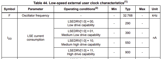

We are using the STM32H753 in our design.
For the signal quality, we are adjusting the LSE drive strength.
Below are the four options available in drive strength,
  1. low drive
  2. medium low drive
  3. medium high drive
  4. high drive
Kindly let us know drive current value of each options for understanding.

mƎALLEm
Apr 9, 2025 8:35 PM UTC
The only current parameter we give in the datasheet (for the silicon rev V) is the LSE current consumption on IDD based on the drive level:

Apr 9, 2025 9:24 PM UTC
Dear @Manikandan ,
LSE drive has nothing to do with signal integrity and here the LSE is 32,768KHz crystal frequency .  LSE drive is explained in here :https://www.st.com/resource/en/application_note/an2867-guidelines-for-oscillator-design-on-stm8afals-and-stm32-mcusmpus-stmicroelectronics.pdf
However, GPIO output drive is very key for signal integrity and use the right drive based on the External signal frequency and load as in datasheet - I/O dynamic speed characteristics.
Hope it helps,
