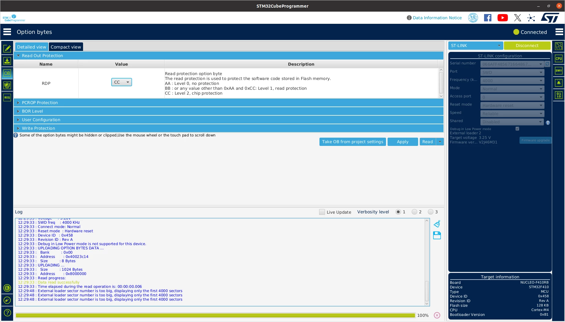

To work around this, I connected to the board using STM32CubeProgrammer and performed a full chip erase using the following settings (details below). I clicked Apply, and the flash erase appeared successful.

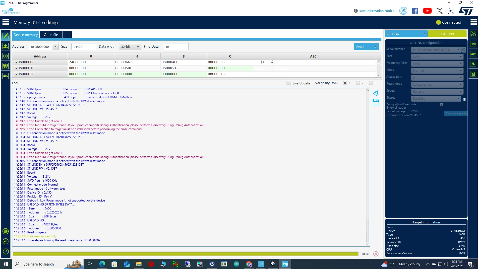

After erasing, I’m no longer able to connect to the board via either Cube IDE or Cube Programmer. I now get:
"Unable to get the core ID"

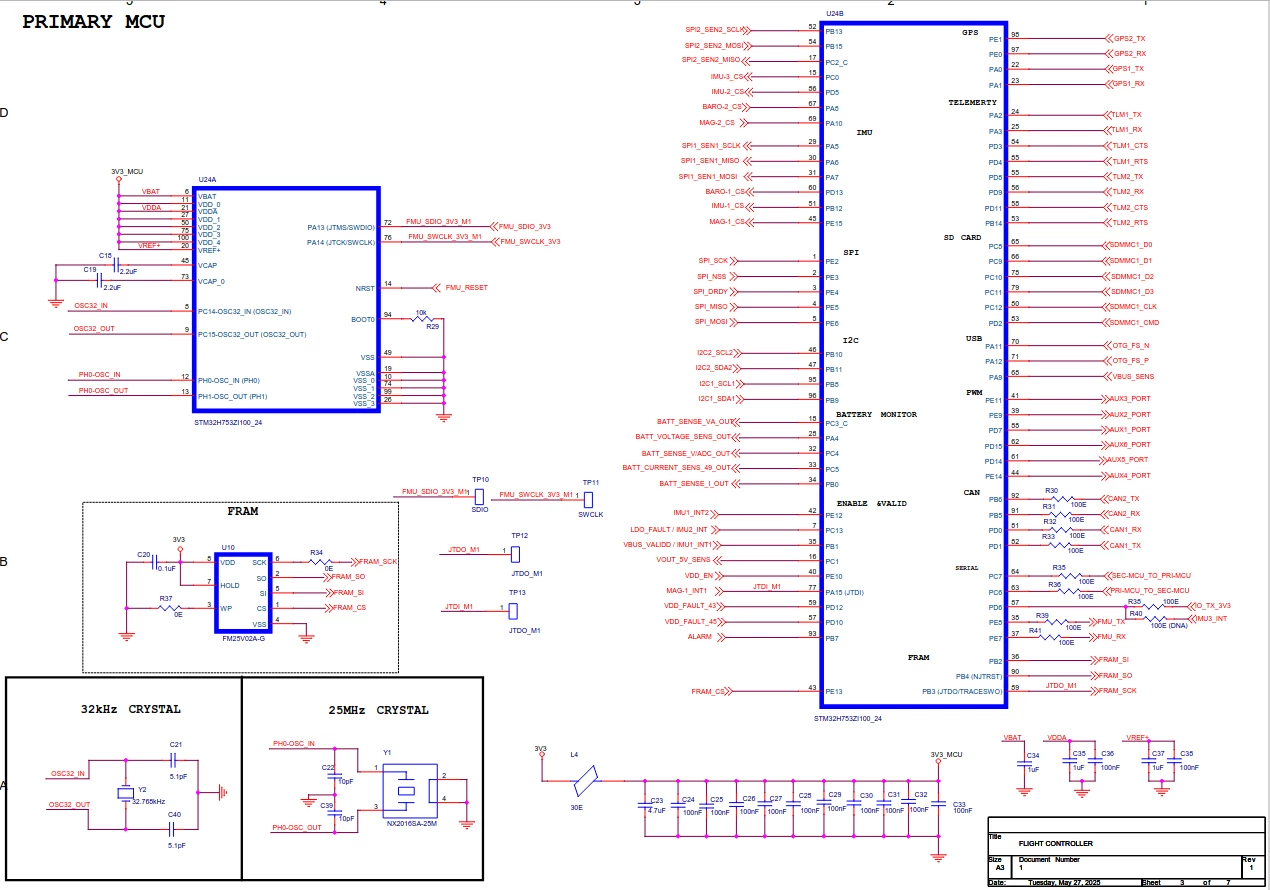

    I will also share the schematics

Are you using STM32F410 or STM32H7? The two screenshots shared different devices.
If the RDP level is set to "CC" level 2 (device protection and intrusion prevention), the below rules apply:

  • I'm using custom board with stm32h753 mcu and to show that what I've enabled i used the stm32f4 (just for an indication of what i have done). But the problem occurs in stm32h753 only.

No, the above the "data read successfully" message you can find an issue of core id got erased. the flash content shown for an other board to check whether that board is getting connected.

Your post says you erased the flash, but your screenshot shows you set RDP level 2. Which one is it? They are very different operations.

Hello @TDK and @KDJEM.1 One of our collegue done this. By sending these screenshot he said that the core id is becomes zero after this. so we try to solve this from his point of view. From this post we came to know that we have just upgraded the protection level of the board. Now our board is in developing condition. Since it's impossible to set the rdp level again to 0 and connecting using st-link also not possible. then how to boot the flash in which protocol?.
Jun 17, 2025 3:08 PM UTC
If you set RDP 2, you can no longer access the chip with STM32CubeProgrammer. There is no way to recover the chip. It's done. Replace it with another chip.
