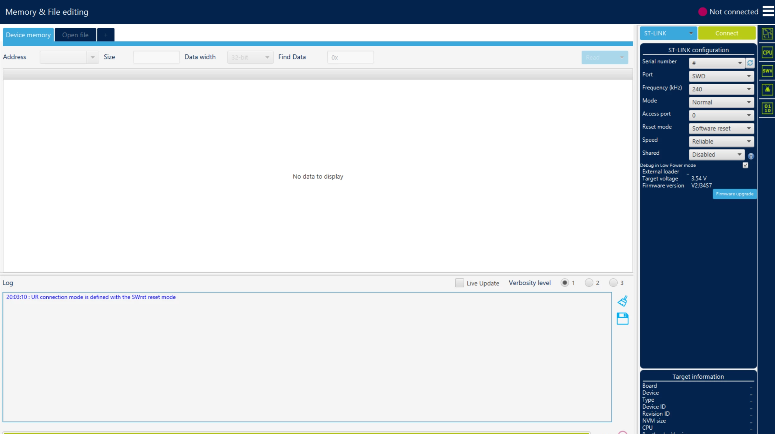

So my STLink just showed up and it seems like the Chip is unfortunately dead.
After Hooking up SWD (to PA13), SWC (to PA14) and GND as per the Docs nothing happens upon connect. (See the attached Screenshot)
Im not quite sure about the Source of the Chip (as ive received it from a friend who had one left) but ive since ordered one from digikey which will show up next week. I dont think there is any Fault in my PCB as each Power In is connected and decoupled using a 100nF Cap. Reset is at 3V3 and VCAP is present and thats all thats required from what I understand.
There are a few peripherials connected to UARTs, I2C etc but that should not be an Issue at least for getting Communication via SWD correct?
Pavel A.
May 2, 2026 8:05 PM UTC
If the ST-LINK connection mode is "under reset" (and NRST is properly wired to the ST-LINK) these peripherals won't get in the way.
