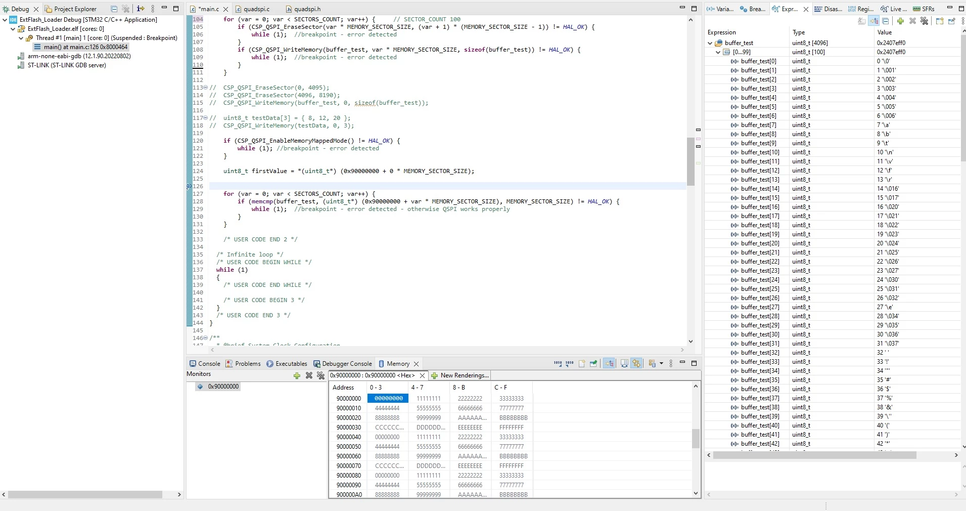

I have an ART_PI board with STM32H750XBHX MCU and W25Q64 FLASH IC on it.
I want to make my own loader, but it doesn't work as it should.
Running until the memcmp cycle, I look at the memory map. But the content is not good. There are values 00000000, 11111111, 22222222 instead of 00, 01, 02. Thus, memory comparison is not good.
I can't find the error.
I am attaching the files and the picture showing the memory map.
Thanks for the help!

Hello @Thomas8607 ,
What frequency of QUADSPI did you use?
Please try to decrease the QUADSPI frequency.
Thank you.

Jan 25, 2024 1:53 PM UTC
Hello
Yes, it was the solution. I configurated the clock to lower frequency.

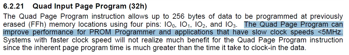

I'd suggest you try erase/program/read cycle first with 1-line mode throughout until you've verified it works as expected, then switch to data on 4 lines for memory mapped read only, and only finally for write, too.
Otherwise it's hard to tell whether the problem is the write, read or maybe both. In particular, without knowing the actual memory contents, it's quite difficult to know whether the read works at all. Hence it might even be useful to insert a pre-programmed flash device (with known contents!) first.
