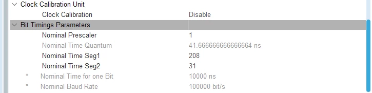

Maybe your sample point could be an issue?  Try these values which is at 87%

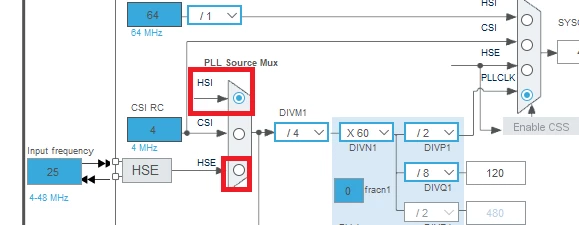

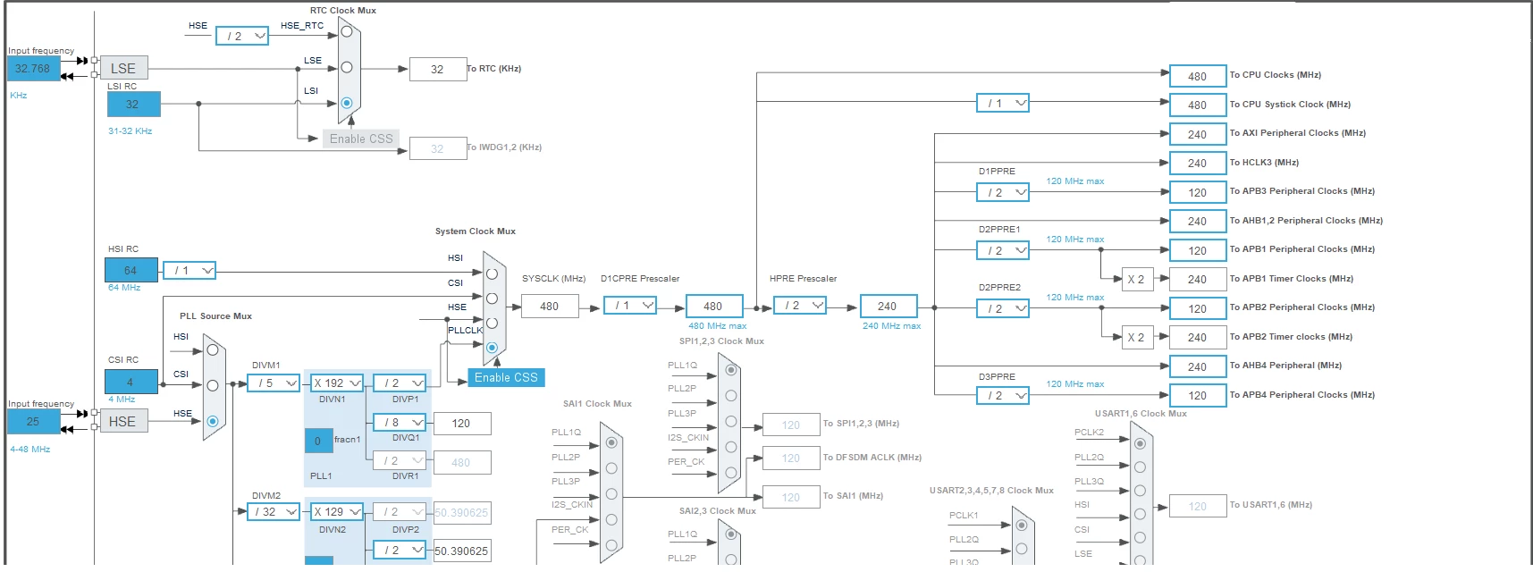

Moreover, as I see from your clock configuration, FDCAN clock is provided by PLL1Q having the clock source HSI.
It's not recommended to use HSI for CAN/FDCAN communication. Use HSE with an external crystal instead.
PS: You are setting your bitrate at 100kb/s. Are you sure it's not 1Mb/s?

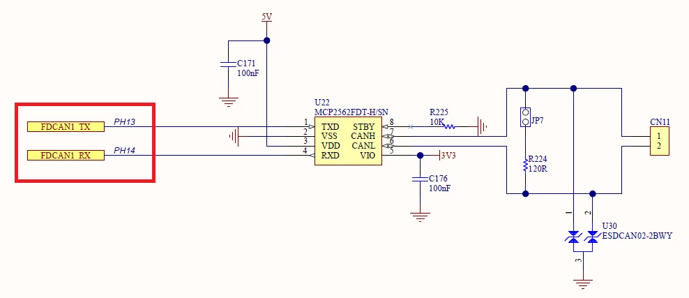

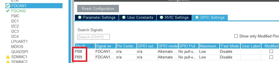

Another question came to my mind: are you using STM32H750B-DK board?
If yes, there is a discrepancy with your GPIOs settings: PB8/PB9 in CubeMx vs PH13/PH14 in the schematics.
PS: FDCAN2 GPIOs are correct.

Hello, I am using the ART-PI development board, I am sending the output schematic and documentation. I'll be back from work in 2 hours and I'll still try to change the configuration as my colleague above wrote, currently I'm at a loss.... I need to make a bridge between CAN1 and CAN2, the FreeRTOS task will not be a good solution here to transmit frames in real time. As I mentioned, such code in RTOS task works fine and I can receive and send back to the bus frames.... :(

I come back to you with answers. I have switched the clock for FDCAN to HSE, it is set to 25MHz.
I switched the prescaller and Time seg1, Time seg2 to as the colleague above wrote. This unfortunately had no effect. When debugging, HAL_FDCAN_ActivateNotification does not return errors. Sending to can works or receiving when I do it in the main while loop in the main() method.

System clock is not yet set to HSE (25MHz) in your latest attached project. Still set to HSI.
+ You lost some user code from this latest version.

If i remember your clock was 24MHz so these are the settings for 500/kbs
