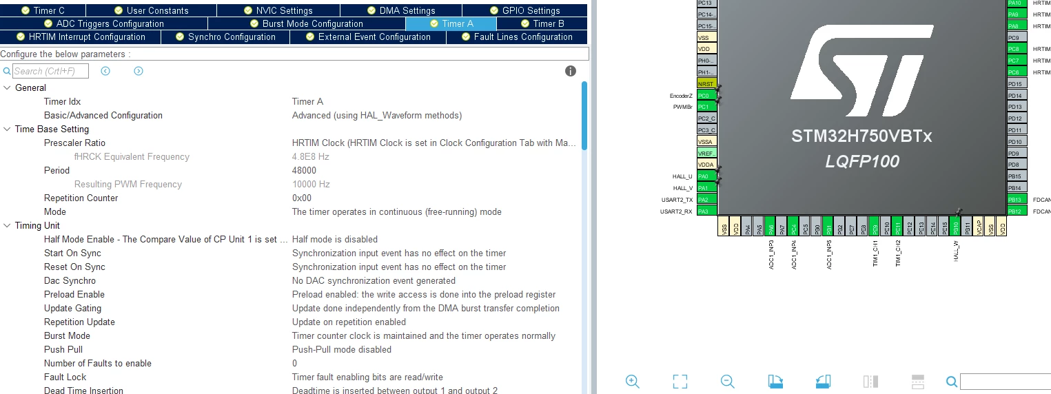

I am using stm32h750vbt6 for pmsm foc. I want to know if there is a way to use hrtim in center aligned mode as it would be needed for svpwm.
Right now I'm updating the duty cycle with the following settings.
Set comparator value: counter value/2 - duty/2
Reset comparator value: counter value/2 + duty/2
And I'm updating on timer update event.
Is there any suggestions or I'm doing it right?

The HRTIMER counters can operate in Up‐Down counting. This mode presents advantages for fixed switching frequency power converters. The HRTIM is natively designed with up-counters. It offers however an operating mode with up-down counters, also called center-aligned mode.
You can configure it by STM32CubeMx: "Up Down Mode",

I am using stm32h750vbt6, does this mcu has center aligned mode in hrtim because i dont see any option in stm32cubemx for it.

Yes indeed, this feature is available for STM32G4 chip which contains an Hrtim version different from the one in h7.
