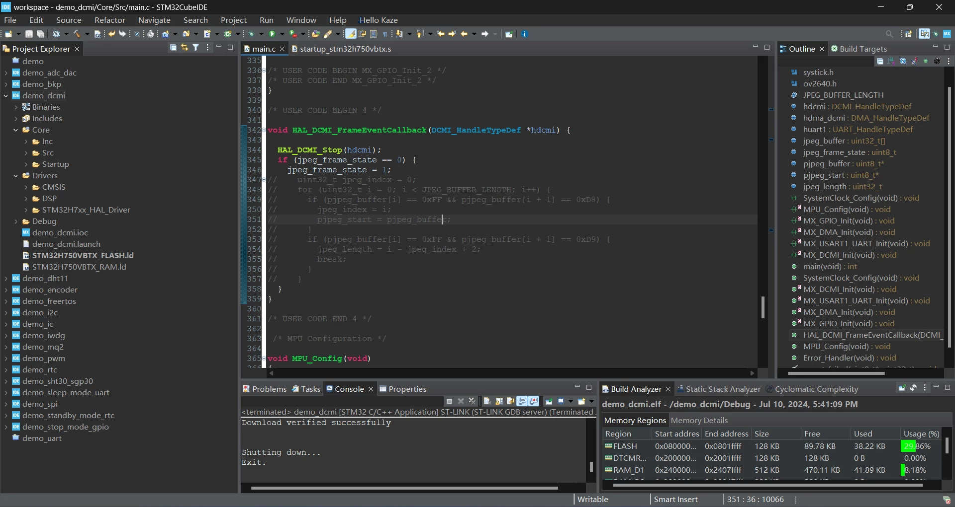

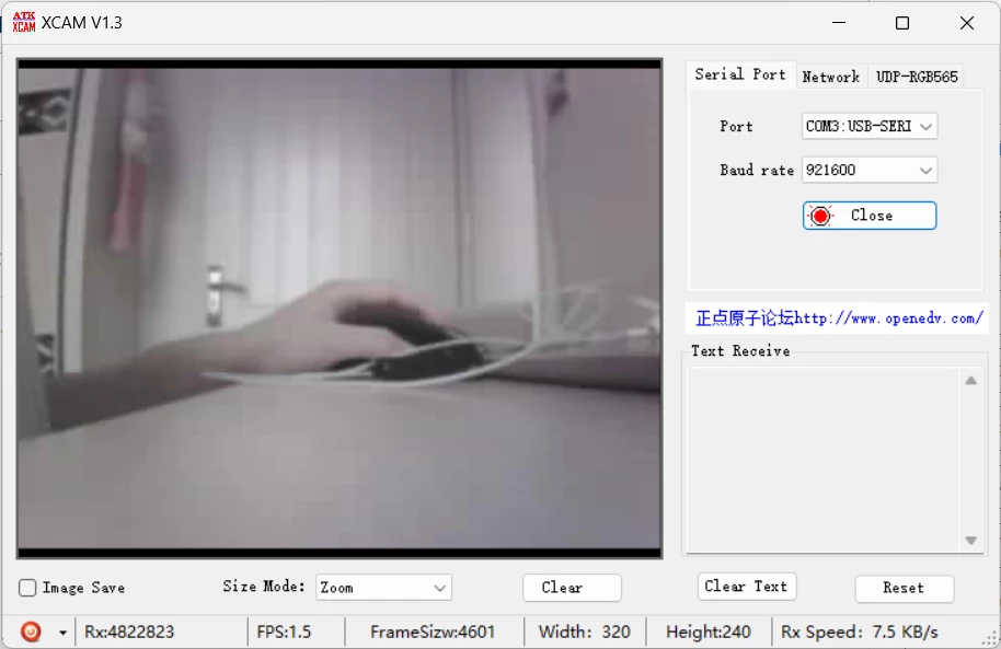

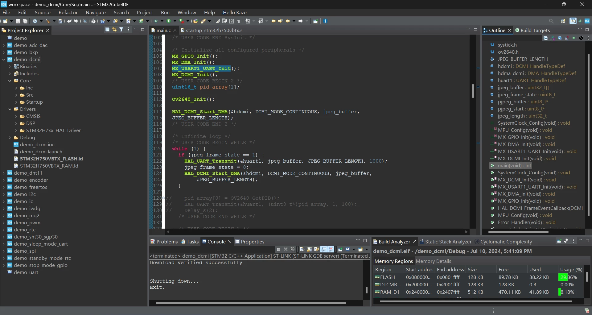

With DCMI (with DMA) and USART only 1.5FPS, why is the frame rate really low?
The output is set to QVGA and formatted as JPEG.

Probably because the bandwidth of.the UART is very low?
ShiinaAuthor
July 10, 2024
I set the baudrate to 912600, and the camera output is JPEG, so I don't think USART is too slow.
Tesla DeLorean
Guru
July 10, 2024
Depends on image size and efficiency. Frame rate suggests images about 60KB

Thanks, I'm using ov2640, which outputs the jpeg directly.

I advise you to take a look at JPEG data capture section in AN5020 may help you to check the DCMI configuration.
Do you have the same issue with a different mode and image size?
