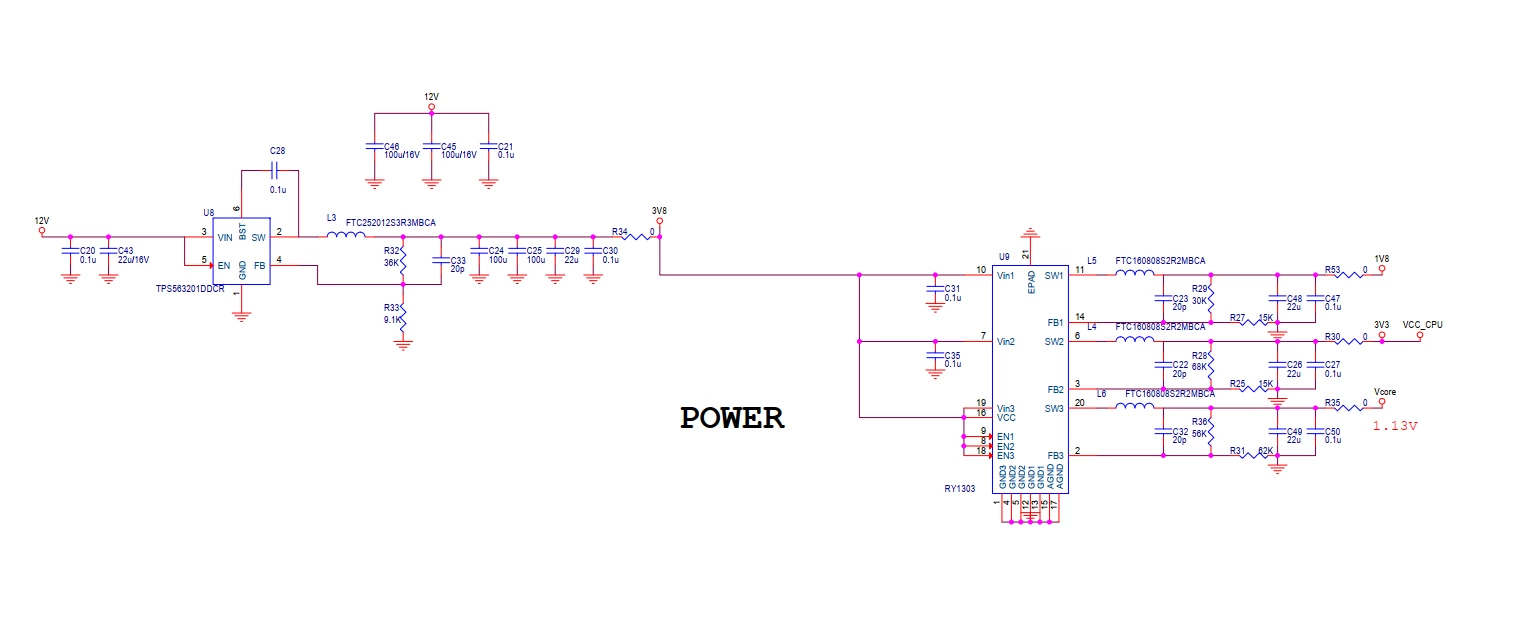

The power supply module:
  • The power supply is designed with 12V input, generating 3.8V, 3.3V, 1.8V, and 1.13V.
  • 3.3V powers the STM32 VDD pins, and 1.13V powers the VCAP pins.
  • Each VCAP pin is decoupled with a 0.1 µF capacitor in parallel with a 4.7 µF capacitor (located close, but not on the same plane due to vias).

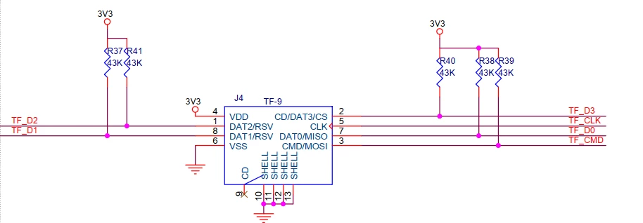

The SD card interface:

4. microSD card testing
I tested three microSD cards:
  • Sandisk SDSQUNC-032G-ZN3MN → CPU reset occurs
  • Kingston SDCS3/64GB → No reset observed
  • Kingston SDCS2/32GB → No reset observed
So the issue seems to be card-dependent, happening only with the Sandisk card.

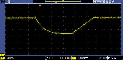

5. Power rail observation
Using an oscilloscope, I checked the power rails:
  • 3.8V and 3.3V → stable, no obvious ripple.
  • 1.13V (Vcore) → shows a significant voltage dip during the reset(waveform attached).

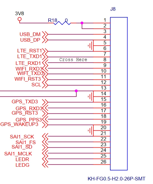

Additionally, I noticed that the problem only occurs when the external connector — which normally distributes 3.8V to other boards — is left unconnected. When the connector is attached (and the system is powering another board), the issue does not appear. Here‘s the connector interface:

the problem is something in your hardware.
1. vcore from a smps - i would call it dangerous or at least: more problematic than using the internal LDO;
2. i use almost only Sandisk sd-cards, because they are the best/reliable , Kingston often "sick" after some time.
3. >the problem only occurs when the external connector .. is left unconnected. <
-> this obviously shows a problem, some imprecise connection , maybe ground loop , bad ground , etc.

Aug 31, 2025 8:55 AM UTC
thank you for your suggestions.
I tried switching to the internal LDO regulator, but unfortunately I couldn’t get the MCU to start up properly in that mode.
Based on your reminder, I went back and checked my external Vcore supply design more carefully. I then realized that the decoupling capacitors on the VCAP pins were placed very far from the MCU pins — more than the distance of about 25 pin pitches, and connected through vias. This may have caused instability on the core supply. I am now correcting the placement of these capacitors (moving them closer to the VCAP pins) and will run further tests to see if this resolves the issue.

SandSwitchAuthorBest answer
Dec 14, 2025 9:57 AM UTC
I finally find the root problem after trying a lot of changes in software and hardware.The sysclk frequency is too high.Using 143MHz instead of 286MHz solved the problem. Now sdmmc r&w never mistakes and mcu never reboots.
