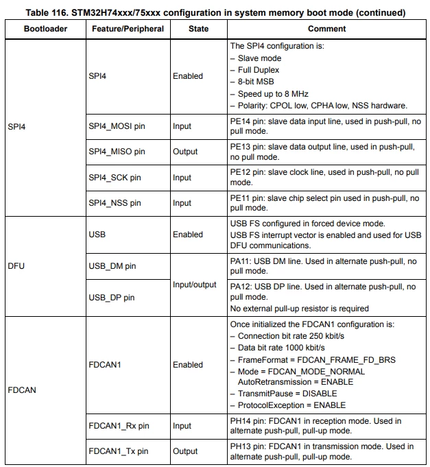

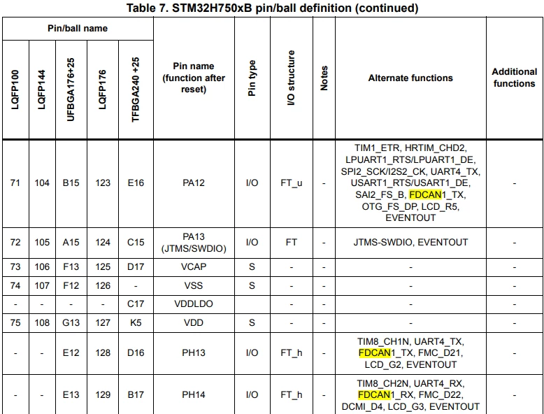

I am trying to confirm that there is not CAN boot loader for the STM32H750VBT6 LQPF100/144 packages. Attached is the pin out included PH13 and PHY 14 and snipped form AN2606 for the STM32H75xx.

I can confirm that there is no FDCAN bootloader since it is available only for FDCAN1 on PH13 and PH14 that are not available on the LQFP100 and LQFP144 Packages of the STM32H750VB. But you still can use the open bootloader.
