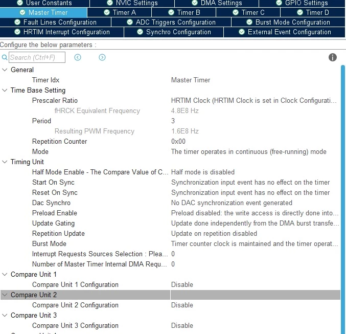

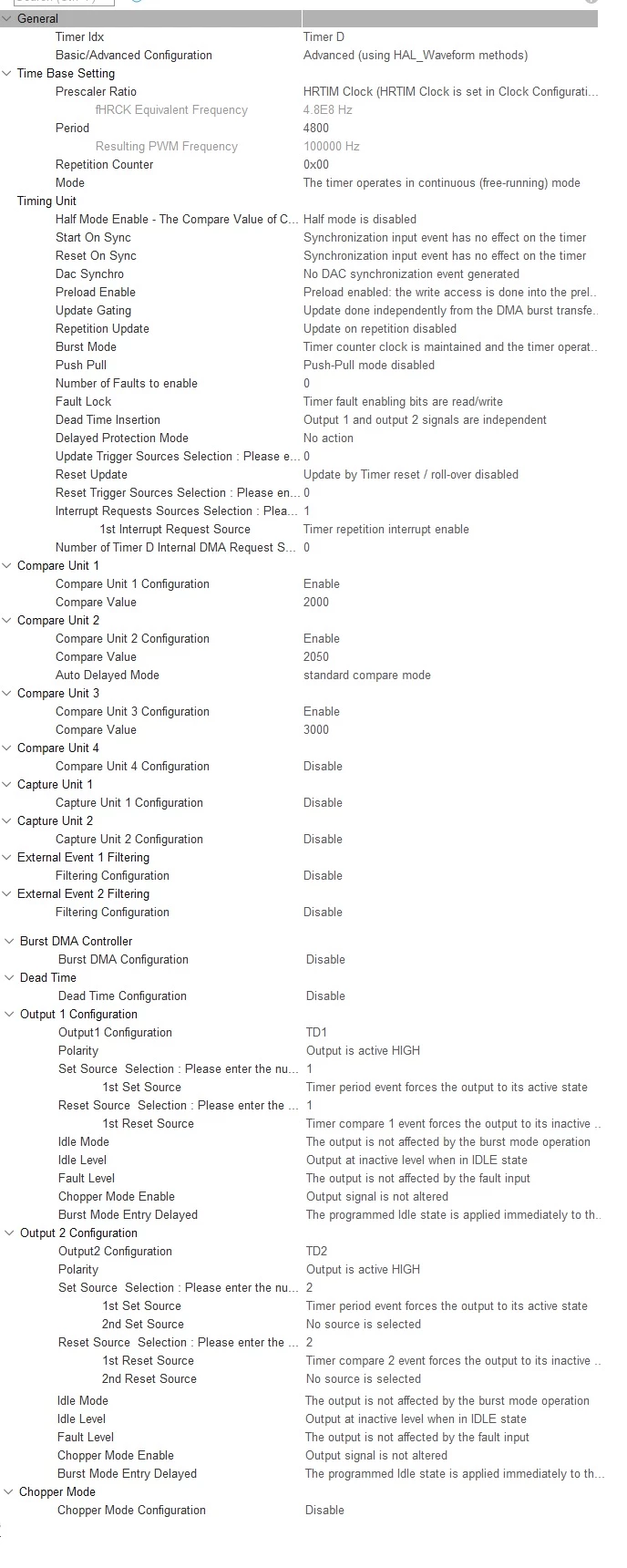

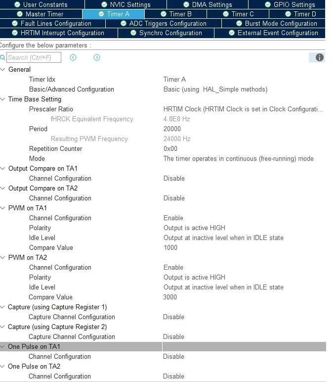

Here are the configurations of the cubeide:
TIMER-D configuration:
TIMER-A configuration:
MASTER TIMER CONFIGURATION:
Best answer by JLope.11
After making this:
HAL_HRTIM_WaveformOutputStart(&hhrtim1, HRTIM_OUTPUT_TA1);
HAL_HRTIM_WaveformOutputStart(&hhrtim1, HRTIM_OUTPUT_TA2);
HAL_HRTIM_WaveformCounterStart(&hhrtim1, HRTIM_TIMERID_TIMER_A) ;
 HAL_HRTIM_WaveformSetOutputLevel(&hhrtim1,
 HRTIM_TIMERINDEX_TIMER_A,
 HRTIM_OUTPUT_TA1,
 HRTIM_OUTPUTLEVEL_ACTIVE);
 HRTIM_OUTPUT_TA2,
 Worked the Timer A1 but not the A2, that is due Weact board uses  the HRTIM legs to connect to USB ,camera, display. I recommend build a custom board.
