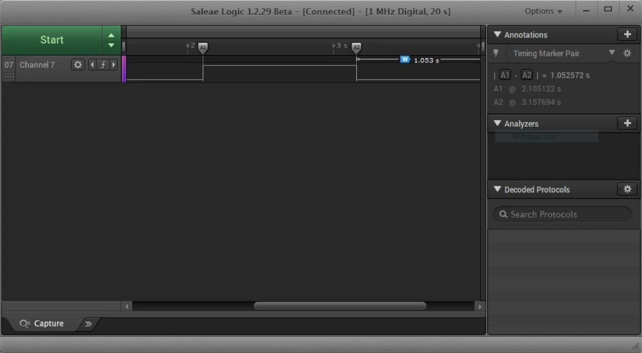

0693W00000D1SppQAF.jpgI had using STM32CubeIDE to generate ADC1 single channel with Timer 6 trigger on 1sec. In HAL library, everything work perfectly and I can see ADC interrupt happen exactly on 1sec interval. But when switch to LL library, same project but the interrupt happen slightly delay, like 1.052s. Just curious what's causing this? can anyone point me out. Thanks

> LL_RCC_HSI_SetCalibTrimming(32);
Comment out this line and try again.

Thanks and it's work!
Could you explain why this need to comment out?

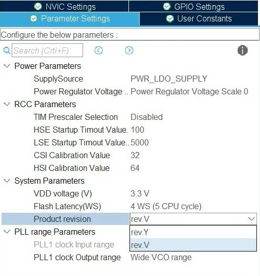

Aug 5, 2021 12:09 AM UTC
The LL library has a history of setting the wrong HSI calibration value, which makes your clock off by a few %, enough to throw off the UART communication. By commenting it out, you use the default, correct value which is set when the chip comes out of reset.
If you go to the reference manual and look up what the default value is, no doubt it is not 32 but maybe 16 or 64.
Please mark the post that helped you as the best answer if you feel it solved your issue.
SEng.1
SEng.1Author
Aug 5, 2021 2:34 AM UTC
Thanks @TDK​ for point out the problem.
I found out that I had mistakenly set the product revision to Y instead of V.
Set it to V revision solve the issue.
