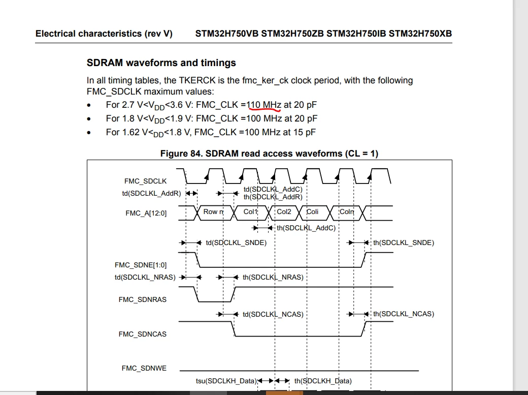

Thanks ,i am from hw side i am still understanding datasheet
but with rev V sample when we run 90MHZ or 99 MHZ it will work but above 100MHZ , SDRAM have 1 bit error in data but datasheet says we can run @110MHZ
here is clock PLL from FW team
t does dome from a PLL. We're feeding the PLL with the 25MHz crystal, then dividing by 5.
For the 115MHz option we multiply by 138 and divide by 2 in the PLL to give the FMC 345MHz.
The FMC then divides that by 3 for 115MHz FMC_CLK.
For the 107.5MHz option we multiply by 172 and divide by 4 in the PLL to give the FMC 215MHz.
The FMC then divides that by 2 for 107.5MHz FMC_CLK.
Similarly for the 90MHz option we multiply by 144 and divide by 4 in the PLL to give the FMC 180MHz.
The FMC then divides that by 2 for 90MHz FMC_CLK.
Not sure it does, it implies that they tested / characterized it on their implementation, not yours. As frequency increases signal integrity issues will be a big issue, and what loads are being driven/over-come. You might want to engage with an FAE, and find out what platform they validated the 110 MHz operation on.
That it's not 120 MHz suggests there's either a critical path, or the IO cell has a drive / energy issue, as there's plenty of SDRAM on the market capable of 133 or 166 MHz operation, I'm prone to think it's an internal or interface limitation.
That yours hits the ceiling at ~100 MHz suggests there's perhaps a board level integrity issue, or that you need to adjust or back-off the slew rate, or check the IO Cell Compensation

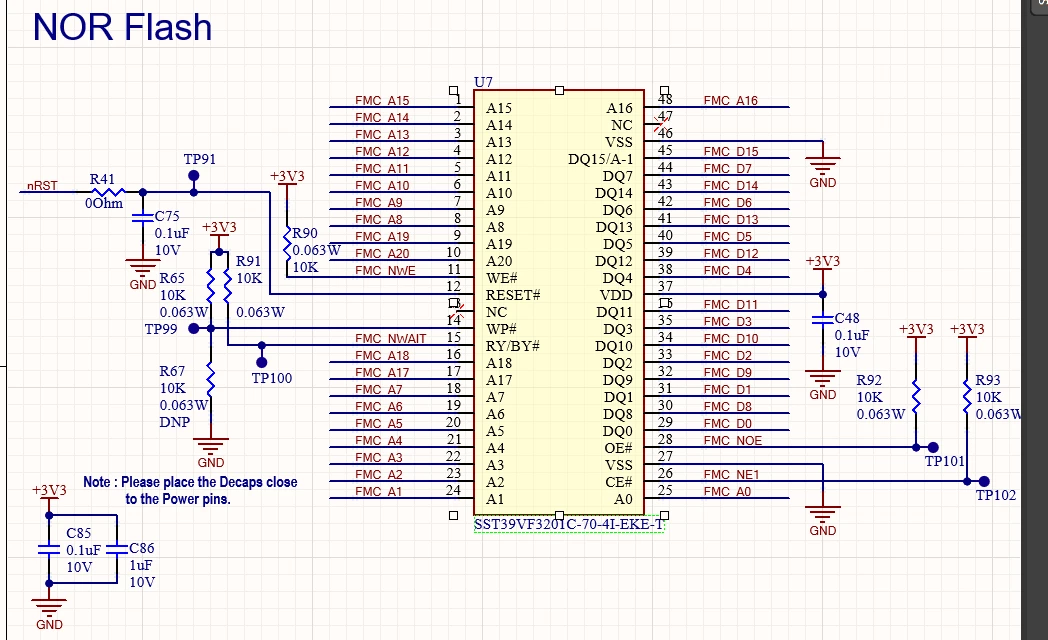

do you think NOR flash load capacitance of 10 pf also limiting frequency for SDRAM to run at limit
