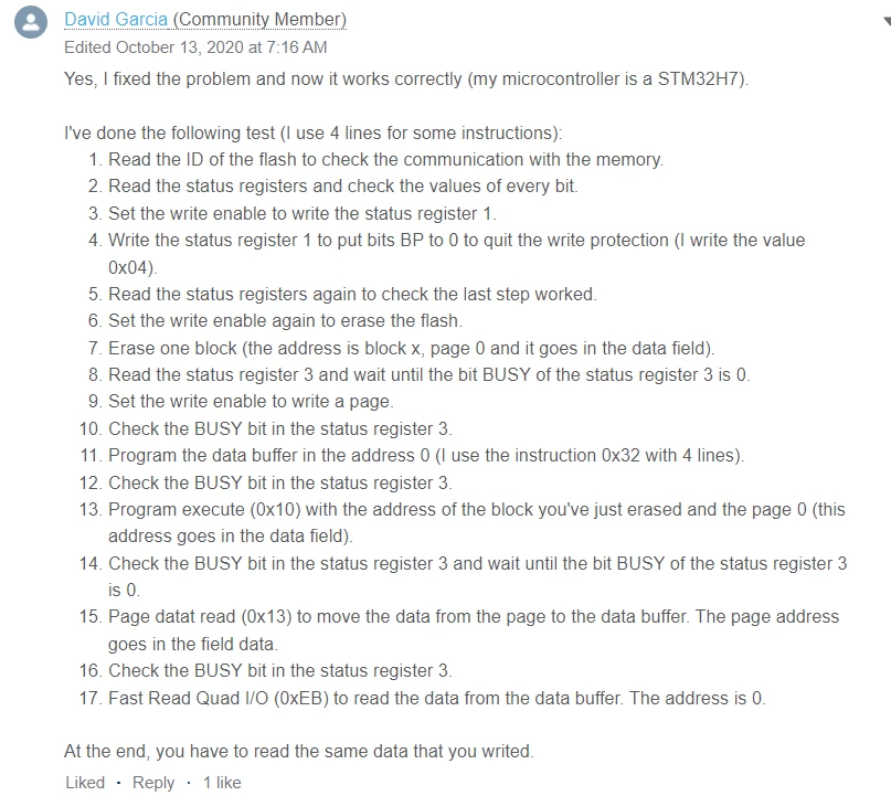

Please, I am working on a Custom Project with STM32H7 platform and I am using a NAND Flash for Data Storage (W25N01GVZEIG). I can execute correctly all commands except :
  • (32h) Quad Program Data Load .
I can write using (02h) Program Data Load with SPI mode with no issues, but once I switch to Quad mode (32h) the data written is not correct, seems there is some bits corruption.
{0x11,0x22,0x44,0x88} is written {0x91,0x22,0x04,0x48}. I suspected the pinout first but the Quad read is working fine.
I saw a similar question QSPI of STM32L496A but didn't fix my issue.
Could you support on this?
Thanks,
Ayoub
Best answer by Ayoub Cheggari
I was suspecting it to be a read issue, but when I write with SPI using cmd (02h), I can read data correctly.
Speaking about the erase, when I execute the Block Erase cmd (D8h), the bits are set to 0 not 1 which is very strange. I will do as you proposed thanks @Community member​  for supporting as always !

Can you send your code? How do you do read, write, erase, execute operations?
I can write using Quad mode (32h) but some pages (2048 byte) are not correct. For example; in block 0, page from 0 to 10 is sucsess but in block 0, page from 10 to 15 wrong.
David Garcia (Community Member)'s answers are very helpful. In this question QSPI of STM32L496A, the codes found here are all working, I followed the instructions.
You problem is like dummyCycles.

Here is the code I am using:
Write: here as we discussed in Linkedin, SPI write works fine but Quad is not as the written data is corrupted somehow. Also, don't need to execute the Program execute cmd to store the data into Physical mem.

Issues tend to be on the READ side, not the WRITE, READs can be tested/validated by either having existing patterns in memory, or using the READ 1, 2 and 4-bit modes and checking they all read the same data.
If on the WRITE side you're going to have to look at signal integrity issues, and meeting expectations of the memory device in terms of how quickly it can ingest data into internal buffers, and how quickly it can write complete blocks to its internal array.
Check that the correct dummy and alternate cycles are programmed.
Check that you are properly/completely initializing the command structures.
Check that the addressing/paging is correct for each command.
Check that data is erased properly.
