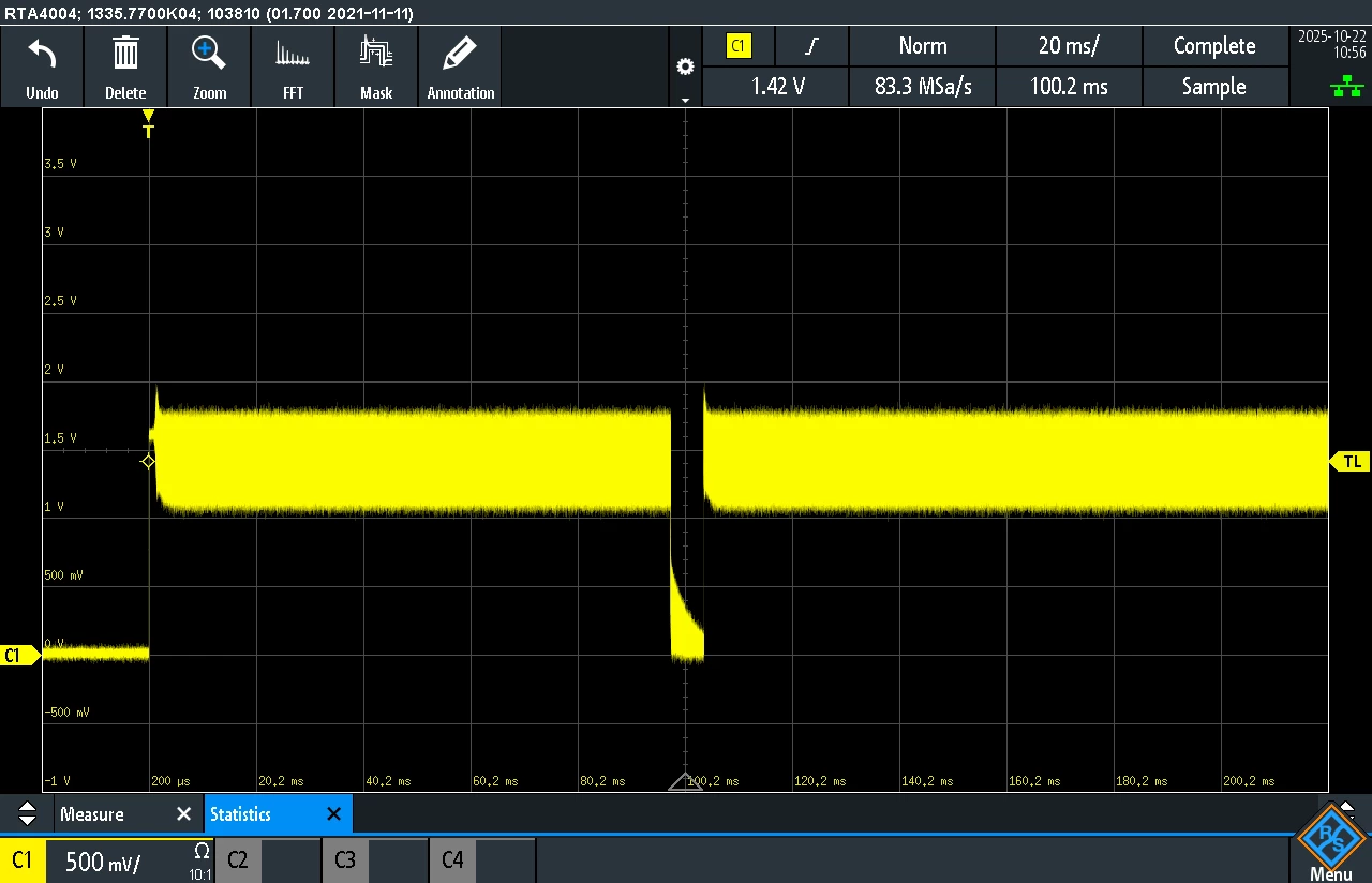

Hey together,
I have a question regarding changing the clock while running in XiP mode. Upfront everything works so far very well.
On our STM32H750 we have a very simple bootloader. This bootloader configures the QSPI and the STM32H7 to run the appliction code in XIP. Therefore we configure the QSPI clock to use the HCLK3 in the bootloader. We use an external crystal 8MHz and the PLL as SYSCLK to generate the 240MHz for the HCLK3. Then we jump to the application code.
The applicaiton code resets the System Clock Mux in the startup code calling "SystemInit ()" inside the system_stm32h7xx.c to use the HSI (64MHz) for SYSCLK. This results at first in a drop of external crystal signal as well as a clock drop of the QSPI Clock from 240MHz to 64MHz. Then we reconfigure in the application code, while running in XiP, the System Clock Mux to use the external crystal and the PLL. Going back to the 240MHz for the QSPI.
So far this seems to work perfectly fine, as there is always a clock present on the QSPI and we do not stuck or so. The question is: Can we keep this as it is? Otherwise we would have to prevent the clock reset inside the "SystemInit()" function somehow. Regenerating via CubeMX will then overwrite this part i guess.

Hey @AScha.3 ,
I understand your solution to keep the clock tree in default for the application code. I guess this will work and will not regenerate the PLL reset inside the SystemInit(). But this is no real solution as all other interfaces which are used in the application would need the correct clock settings to show the right configuration inside of CubeMX.
But I tried to comment the PLL reset inside the SystemInit() and regenerated the Code via CubeMX. It seems that CubeMX does not regenerate the "system_stm32h7xx.c". This is good as i can prevent it in this way.
Hopefully ST keeps that there is no regeneration of "system_stm32h7xx.c".
