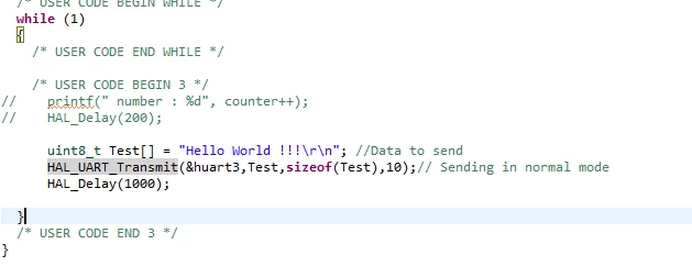

Hi, may i know how to use the uart using stm32h750. I just try using the basic uart application which is hello world but nothing show up. I literally follow same setting with nucleo board for uart. but it does not working with stm32h750? May i know if its different setting or i miss something?
btw I am using tera term as a serial monitor. Anyone know where can i refer or anyone can just show me how to do that?

You really need to give more information. You say you followed the same settings as the nucleo board but does that mean it's using the same UART port? You need to post your code that transmit and the array that you're using for the data.

I followed this one https://wiki.st.com/stm32mcu/wiki/STM32StepByStep:Step3_Introduction_to_the_UART but for STM32H750XBH-DK board I am using the USART3 which is PD8 for TX and PD9 for RX.
This is code i using for STM32H750XBH-DK
0693W00000WLVLoQAP.pngDo I need to enable another peripheral beside USART?

December 21, 2022
USART3 is on PB10 and PB11 which uses the STLINK VCP, or ST-MOD or Arduino connector. Even though USART3 can use PD8 and PD9, those pins go to the SDRAM on the dev board so you have no access to those pins.
Be sure to study the schematics so the pins you've selected don't go somewhere else.
https://www.st.com/resource/en/schematic_pack/mb1381-h750xb-b01_schematic.pdf

December 21, 2022
ohh thank you ! I got it. I will study the schematic well since I also still new to the environment
