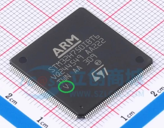

Hello ST experts,
I have bought a STM32H750IBT microcontroller. Could you please let me know how I can find whether it is V revision or Y revision device?

https://www.st.com/resource/en/reference_manual/rm0433-stm32h742-stm32h743753-and-stm32h750-value-line-advanced-armbased-32bit-mcus-stmicroelectronics.pdf#page=3208
DBGMCU identity code register (DBGMCU_IDC)
Bits 31:16 REV_ID[15:0]: Revision
0x1001 = Revision Z
0x1003 = Revision Y
0x2001 = Revision X
0x2003 = Revision V
