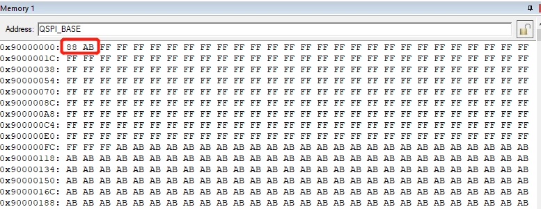

Hello everyone!
I use the Quad SPI flash of stm32 h750. I write data at a certain address through commands, such as address 0. But after configuring the memory mapping mode, I check that the data at address 0x90000000 is 0x88, while my data is at 0x90000001.
more info:
Use Keil MDK software
My operation:
1.Config Quad SPI
2.Write data (0xAB) to address 0
3.Read data in addre 0 (success)
4.Set memory mapped mode
5.Read data in 0x90000000, data is 0x88(error)
I have two questions:
1.After I write data to  address, in the memory mapping mode, the data is at address +1(byte), is this normal?
2.Why can't the operation reach address 0?Seems to be caused by problem 1
Thanks!

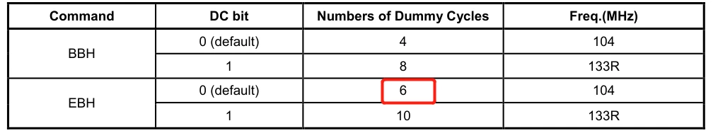

Hi Andex,
This reminds me of the first time I used this mcu with that NOR flash! I suppose you are using the STM32H750-DB.
I think the issue here is the Dummy Cycles in Memory Mapped Function, it should be 6 not 4, with that, you have skipped 1 byt (2 * 4 = 8bits = 1byte)

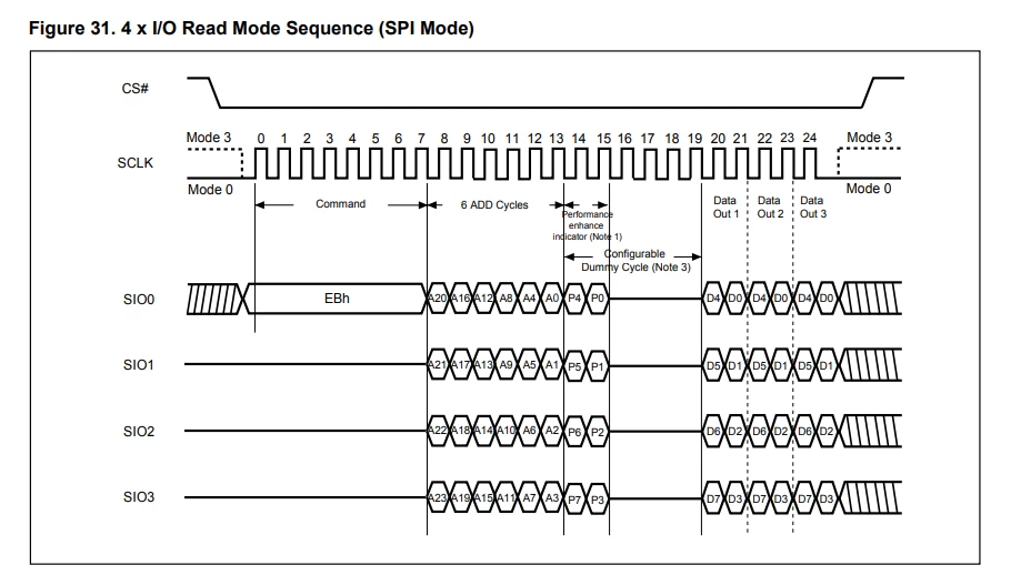

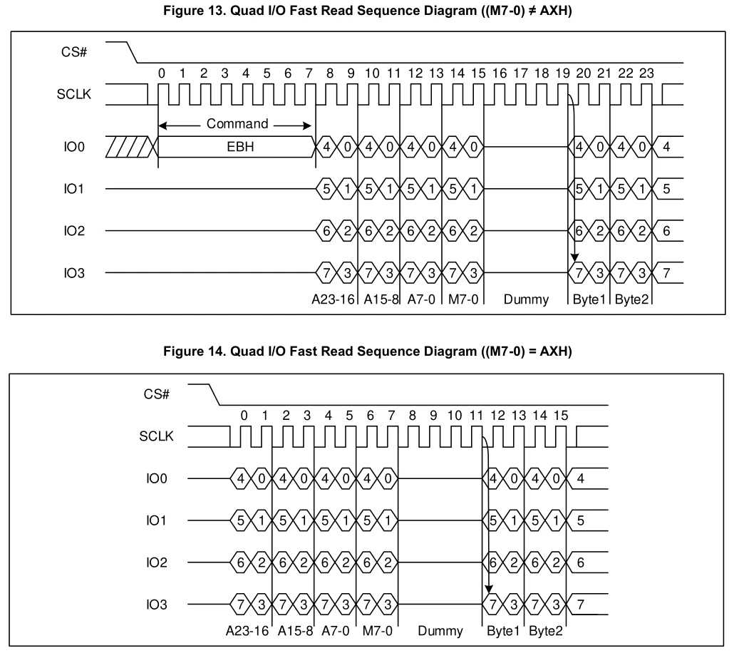

AndexAuthor
Jul 11, 2023 6:43 AM UTC
Hi Ayoub:
I'm very thank you for helping me solve this problem.
When I set 6-dummy clock, the data is normal!
But I check the sequence diagram is, and maybe it includes 'M0-M7' clock-bit?:

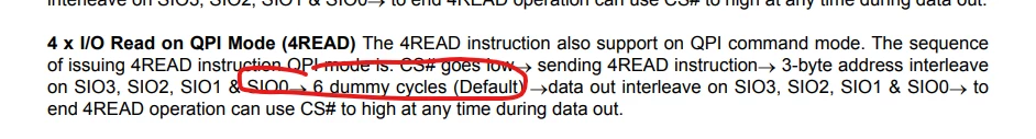

AndexAuthor
Jul 11, 2023 7:05 AM UTC
I found a table about the dummy clocks.
