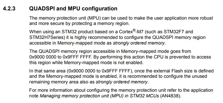

I have a question regarding MPU settings for an external QuadSPI Flash. We have a project where the full application code is placed onto the 4MB Quad SPI Flash memory W25Q32JVSIM. We have set up the QuadSPI in MemoryMapped moded and placed the application into the location 0x90000000. So far everything is fine and works as expected. Now we want to setup the MPU correct for this section. The only thing I found was in the document AN4760 on page 46. There is the follwoing indicated:
0693W00000D2Al3QAF.pngSo I set up the region as follows:
MPU_InitStruct.Enable = MPU_REGION_ENABLE;
 MPU_InitStruct.Number = MPU_REGION_NUMBER3;
 MPU_InitStruct.BaseAddress = 0x90000000;
 MPU_InitStruct.Size = MPU_REGION_SIZE_4MB;
 MPU_InitStruct.TypeExtField = MPU_TEX_LEVEL0;
 MPU_InitStruct.AccessPermission = MPU_REGION_FULL_ACCESS;
 MPU_InitStruct.DisableExec = MPU_INSTRUCTION_ACCESS_ENABLE;
 MPU_InitStruct.IsShareable = MPU_ACCESS_SHAREABLE;
 MPU_InitStruct.IsCacheable = MPU_ACCESS_NOT_CACHEABLE;
 MPU_InitStruct.IsBufferable = MPU_ACCESS_NOT_BUFFERABLE;
 HAL_MPU_ConfigRegion(&MPU_InitStruct);
 /* Enables the MPU */
 HAL_MPU_Enable(MPU_PRIVILEGED_DEFAULT);
Is this the correct setting for code execution from an external quad-spi memory?
By the way: There is another region defined which prevents the access to the rest of the unsed area.
Many thanks in advance,
Eric

    ESawa.1
    ESawa.1Author
    August 11, 2021
    Hey Tesla,
    thanks a lot. Regarding region1, this is clear this is to prevent speculative access on the unused area. Region2 seems to be for data or similar. But for Region4, I am a bit confused now. It seems that there are 3 different settings for similar applications:
    From your post:
    When I check here Region4, which is the most interessting one as I want to execute code, I see that there the area is set to "Normal, write through, no write allocate".
     MPU_InitStruct.BaseAddress = QSPI_BASE_ADDRESS;
     MPU_InitStruct.Size = MPU_REGION_SIZE_2MB;
     MPU_InitStruct.IsCacheable = MPU_ACCESS_CACHEABLE;
     MPU_InitStruct.IsShareable = MPU_ACCESS_NOT_SHAREABLE;
     MPU_InitStruct.Number = MPU_REGION_NUMBER4;
     MPU_InitStruct.SubRegionDisable = 0x00;
    AN4760 on page 46:
    They recommend to set it as strongly ordered memory which would be:
    From STM32 MPU tips video:
    https://www.youtube.com/watch?v=6IUfxSAFhlw --> time: 16:02
    There they recommend to set it as "Normal, write and read allocate"
     MPU_InitStruct.TypeExtField = MPU_TEX_LEVEL1;
     MPU_InitStruct.IsBufferable = MPU_ACCESS_BUFFERABLE;
    But what is the right one for executing code?
    Sorry for my confusion.
    Eric
    Tesla DeLorean
    Guru
    August 11, 2021
    I think the first is a catch-all processed first (NO_ACCESS) to establish how the memory should be dealt with
    I think you want caching, but not buffering or writing.
    Most part you want full device accessible for XIP, one could perhaps partition in linker script to add some protection, but would need consistent application.
