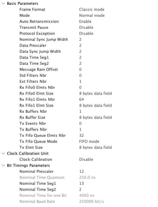

Dear Sirs,
I am implementing an interface between an STM32H750 and a CanBus device of an electric bike. I have the FDCAN peripheral configured to 250kbit/s (FDCAN clock is 48MHz)
I have to interface with devices that use Extended Frames, but the speed is fixed to 250bit/s, so I wanted to use normal mode.
First I ninitialize the peripheral as:
// Configure TX Header for FDCAN2
 CAN_TxHeader.Identifier = 0x03;
 CAN_TxHeader.IdType = FDCAN_EXTENDED_ID;
 CAN_TxHeader.TxFrameType = FDCAN_DATA_FRAME;
 CAN_TxHeader.DataLength = FDCAN_DLC_BYTES_8;
 CAN_TxHeader.ErrorStateIndicator = FDCAN_ESI_ACTIVE;
 CAN_TxHeader.BitRateSwitch = FDCAN_BRS_OFF;
 CAN_TxHeader.FDFormat = FDCAN_FD_CAN;
 CAN_TxHeader.TxEventFifoControl = FDCAN_NO_TX_EVENTS;
 CAN_TxHeader.MessageMarker = 0;
 /* Configure standard ID reception filter to Rx buffer 0 */
 CAN_FilterConfig.IdType = FDCAN_EXTENDED_ID;
 CAN_FilterConfig.FilterIndex = 0;
 CAN_FilterConfig.FilterType = FDCAN_FILTER_DUAL;
 CAN_FilterConfig.FilterID2 = 0x0;
 CAN_FilterConfig.RxBufferIndex = 0;
 if(HAL_FDCAN_ConfigFilter(&hfdcan2, &CAN_FilterConfig) != HAL_OK)
	 Error_Handler();
 if(HAL_FDCAN_Start(&hfdcan2)!= HAL_OK)
	 Error_Handler();
 if (HAL_FDCAN_ActivateNotification(&hfdcan2, FDCAN_IT_RX_FIFO1_NEW_MESSAGE, 0) != HAL_OK)
	 /* Notification Error */
	 Error_Handler();
 if(HAL_FDCAN_AddMessageToTxFifoQ(&hfdcan2, &CAN_TxHeader, &CAN_TxData[0]) != HAL_OK)
	 Error_Handler();

Debugging the code, placing a breakpoint, I get that rtv is always HAL_OK, and if with the oscilloscope I monitor the CAN_TX pins, there is activity, but then in the bus, there is no activity (CANH/CANL lines)
I have been going back and forth with this for days, and I do not know what can be problem.
Is it something with initialization? Probably with the FIFO?
I do not want to filter Messages on the Bus, as this will interface with a lot of different devices.
Thank you so much in advance,
Best regards

What frame format your CAN bus needs to support classic or FD?
I see in your code:
Are you sure it's FD?
You didn't share your CAN initialization code.
I suggest to share your project so we can check all the parameters and config.
Please remove all the stuff not related to the CAN. Keep only the minimal but a complete project that let others run a test.

Changing this:
Fixed the issue
