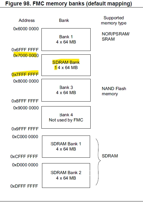

maybe this MCU is pretty old but... I'm designing HW for the H75x using SDRAM on bank 1 (SDCKE0+SDNE0).

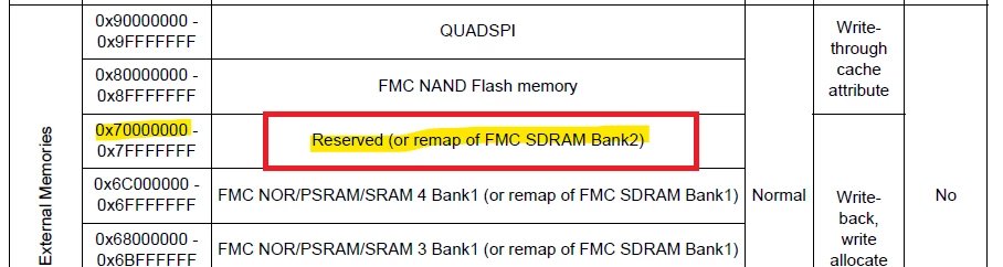

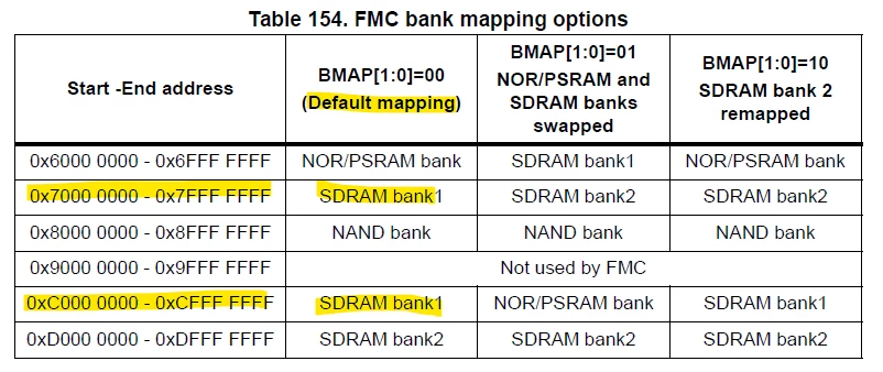

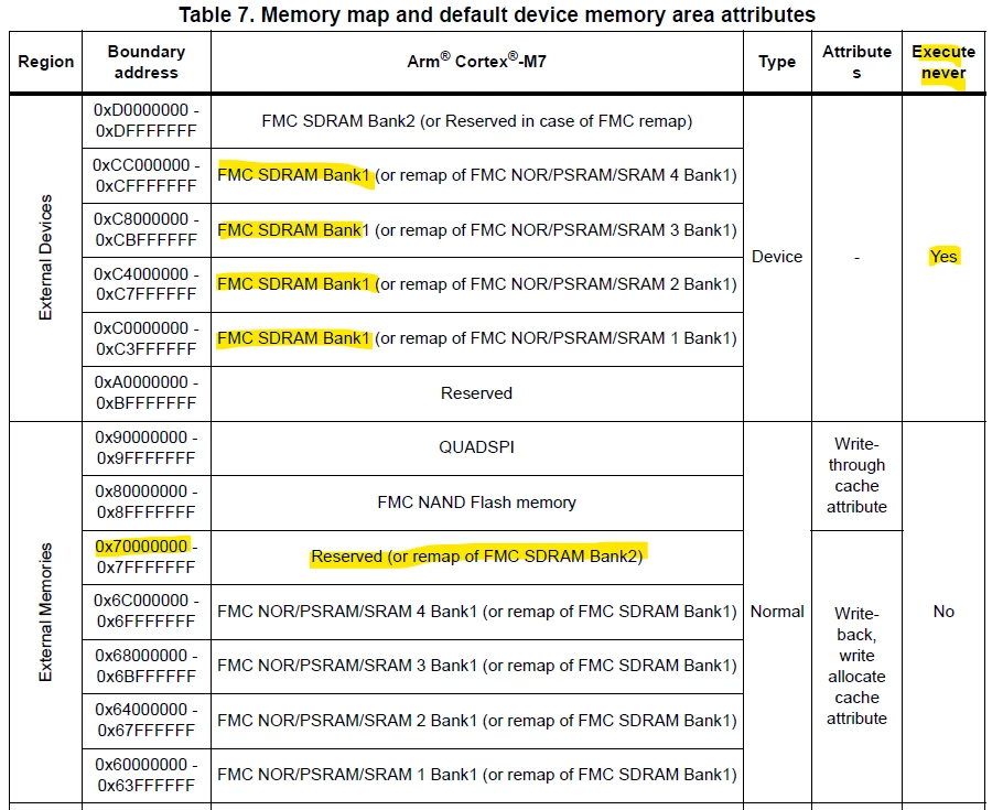

RM0433 table 154 shows text "SDRAM bank 1" at 0x7000.0000 and 0xC000.0000, also figure 98 but table 7 "Reserved or remap of SDRAM Bank 2".RM0433_table154.png
Q1: Is this an error in the documentation? If so, which table is correct?
Q2: Does this mean that SDRAM is accessible at two different memory regions at the same time, e.g. SDRAM bank 1 at 0x7000.0000 and 0xC000.0000? How, what for?
Q3: I guess that storage in the "External Devices" region (BTW: what does this name stand for?) is not write cacheable, not executeable but read cacheable?
Q4: If the NOR/SRAM bank is remapped to this region, the MCU cannot execute code from this device?
Q5: If the SDRAM is in the "External Memories" region, does this have a significant performance boost e.g. if data is stored here? Is there any drawback?
I have a STM32H753_EVAL2 on my side so I can do some tests if required/recommended.

Hello @regjoe ,
Getting back to your original question regarding the SDRAM mapping, the reference manual and the application note are correct and confirm my saying: the SDRAM has an alias and seen by CPU on both addresses on the same time.

Hello @regjoe,
We don't consider it as an old MCU ;)  and I invite you to read the AN4891 "STM32H72x, STM32H73x, and single-core STM32H74x/75x system architecture and performance"
I think most of question are answered there.

Hello SofLit,
thanks for your fast reply.
I already noticed AN4891 but unfortunately, it did not answer all my questions.
Regarding Q1, it increases the likelyhood that there is an error in RM0433 table 7, but still unconfirmed.
Regarding Q3, I'm still puzzled about the meaning of "cacheable". Does it stand for "read / write cacheable"? I'm still unsure if "External Devices" is "read cacheable" or not.

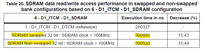

Regarding Q5, AN4891 table 20, it is hard to believe that there is obviously no difference if SDRAM is in a "cacheable" region or not. If somebody has an explanation for this, please let me know. Otherwise I'll dive into the code and check it out on the EVAL board.
Regarding Q2/Q4, please point me to the appropriate information to answer these questions.
Best regards
This is why I've anticipated by mentioning "most of questions" not all of them.

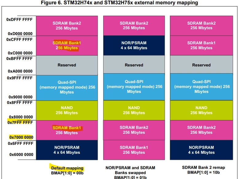

Regarding your question "Q2: Does this mean that SDRAM is accessible at two different memory regions at the same time, e.g. SDRAM bank 1 at 0x7000.0000 and 0xC000.0000? How, what for?"
I think it's an address with an alias so it's accessible on both addresses: cacheable/executable - not-cacheable/execute never.
In default mapping SDRAM BANK1 is seen in both addresses: 0x7000 0000 & 0xC000 0000.
Same case for SDRAM BANK2 BMAP[1:0] = 01b: SDRAM BANK2 is seen in both addresses: 0x7000 0000 & 0xC000 0000. I need to confirm that internally and get back to you.

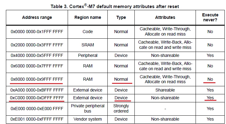

The cachability is something seen by the Core itself and depends on the default MPU config.
For ARM this is the default memeory attributes for CM7:
AN4891 / Table 3:
Type: Normal means cacheable, Device means not cacheable.
Even you enable the cache and you perform an access to a Device region it will be not cacheable.
regarding your question Q5:
These results are provided for STM32H743-EVAL board and the default SDRAM BANK2 address (without swap) is 0xD000 0000 which is not cacheable and Execute NEVER..
So to make that region cacheable/executable, either to swap the address using BMAP[1:0] bits or configure that 0x7000 0000 (see table 3 above) or configure that region (0xD000 0000) as cacheable and make it executable. Please refer to the package X-CUBE-PERF-H7  / Config 6 - D1_ITCM - D1_SDRAM / Project config: SDRAM_ADDRESS_SWAPPED.

So, the two performance have almost the same result if:
The data are located in NORMAL region with cache enabled either by swapping the address or by configuring it as Normal using MPU.

Hello @regjoe ,

Hello SofLit,
if Table 7 is correct, it is confusing me. "Reserved" does not necessarily imply an "alias" feature, IMHO.
Thanks
mƎALLEm
Nov 18, 2024 1:01 PM UTC
I see .. Will be escalated internally..
reserved needs to be "SDRAM BANK1 or remap SDRAM2"
