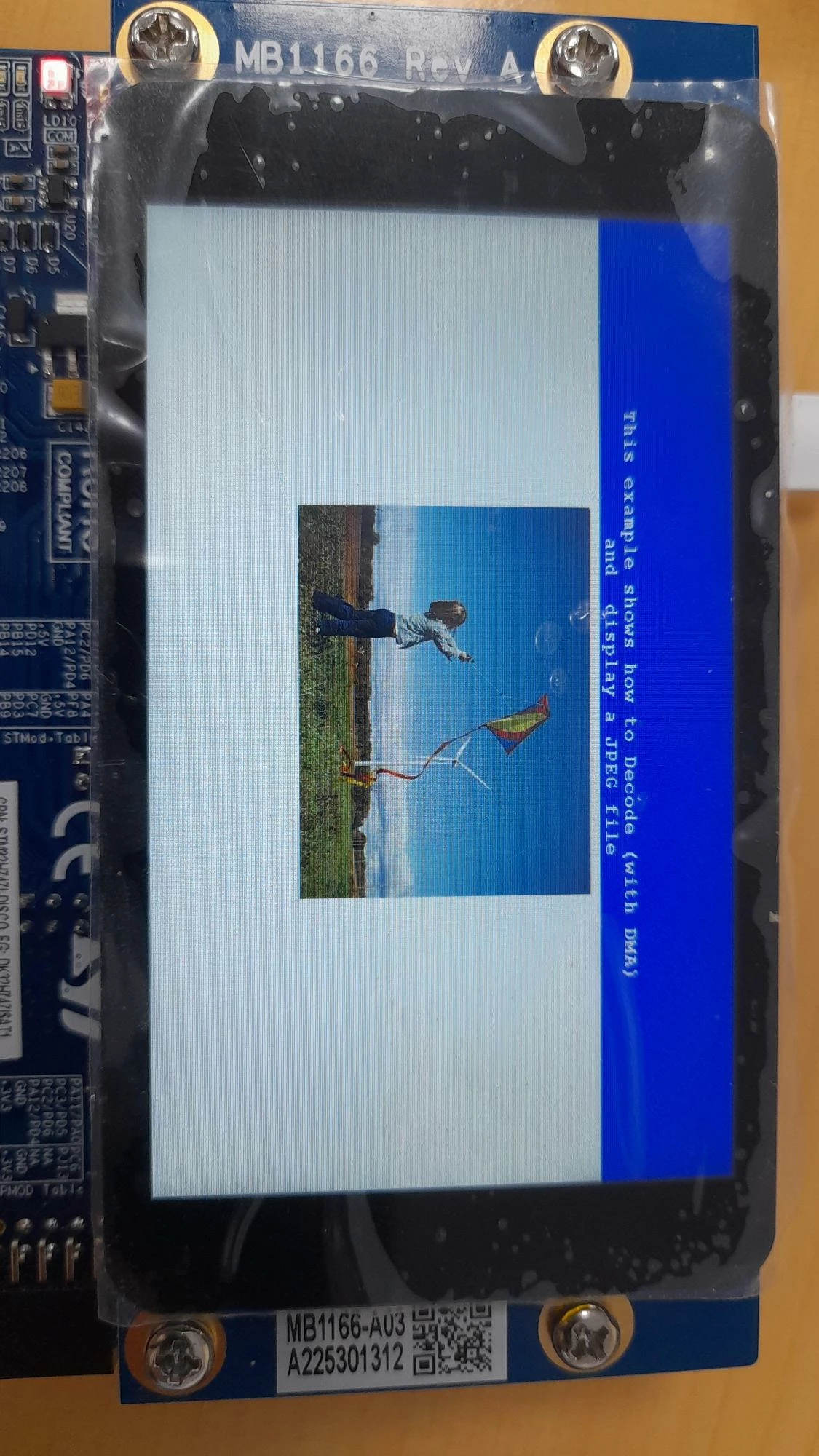

Hi all,
I´m new to STM32 and just recently bought an STM32H747I-DISCO. I needed one with a touch screen for a project. I was going thru the examples and got the LCD DSI SingleBuffer to work but was having problems with the JPEGDecodeFromFLASH DMA. I used the example given on STM32CUDEIDE, builded the project, debug and hit run but kept getting a white screen. I tried reinstalling the IDE and change workspace and ran it multiple times but couldn´t get the image to show. Is there a setting that needs to be set on the board first or do I need to upload a JPEG image into one of the folders?

Please make sure that the display is correctly connected to the board. For that please unplug and plug the display.
I tested JPEG_DecodingFromFLASH_DMA example located in STM32CubeH7 1.11.2 version with STM32H747I-DISCO board D03 and  MB1166 A-03 and using STM32CubeIDE1.15.0 version and it works properly.
To check the issue could you please precise:
  • Which STM32H747I-DISCO revision are you using? MB1248-H747I-D02, MB1248-H747I-D03 ...?
  • Which LCD revision are you using? MB1166 A-02, A03, A09.....?
