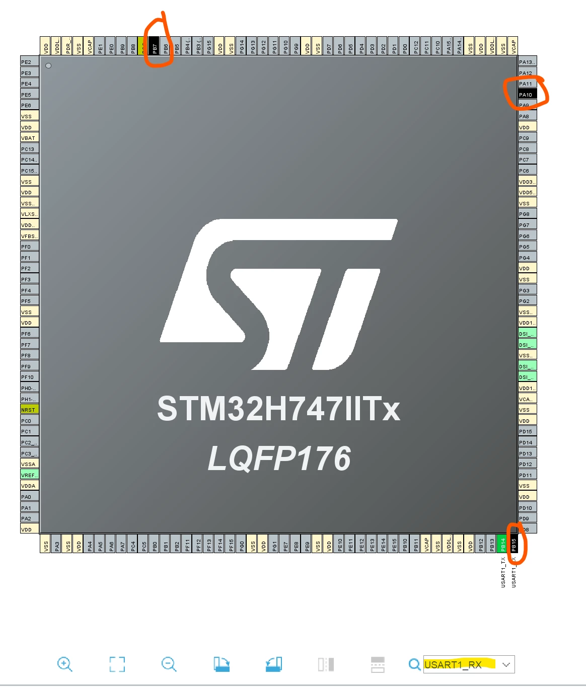

Karl Yamashita
Principal
January 28, 2025
That's not a bug. USART1 has 3 user selectable Rx pins, and 3 user selectable Tx pins. You just have to override what CubeMX selects when you enable USART1. So in CubeMX, left click PA9 and PA10 pins and choose USART1 Tx and Rx configuration.
Or search for it. For Rx example, you can see the 3 black pins that are available

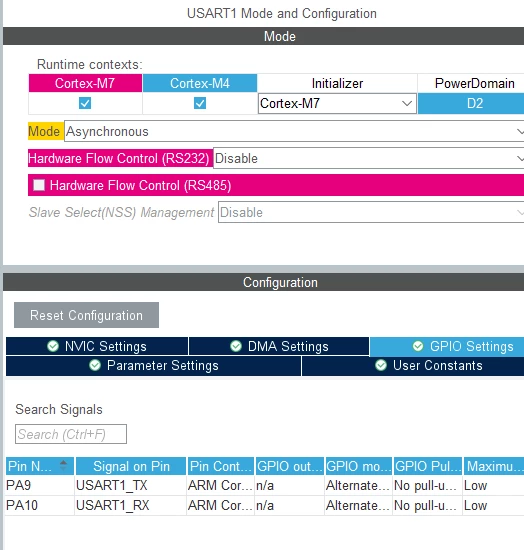

@Andrew Neil, @Louie88
I checked with latest CUBEMX 6.13.0, starting a brand new project from "Acces to BAORD Selector", then picked up the
Then, i choose to initialize all peripherals to their default configs.
And I could check that PA9/PA10, are properly assigned to USART1 TX/RX.
So no issue in CubeMX from my point of view.

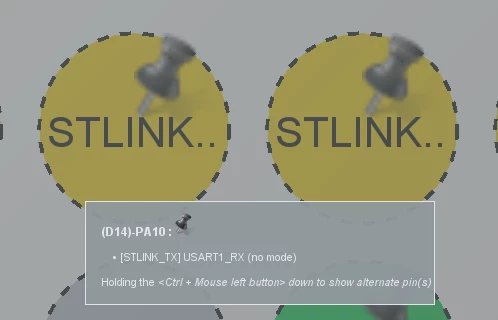

January 28, 2025
Indeed.
I just tried creating a project for the STM32H747I-DISCO board, and CubeMX clearly identifies the pins connected to the ST-Link VCP:
