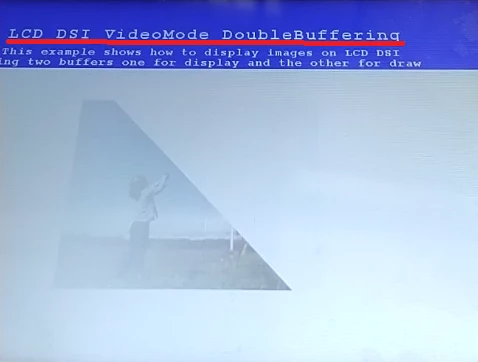

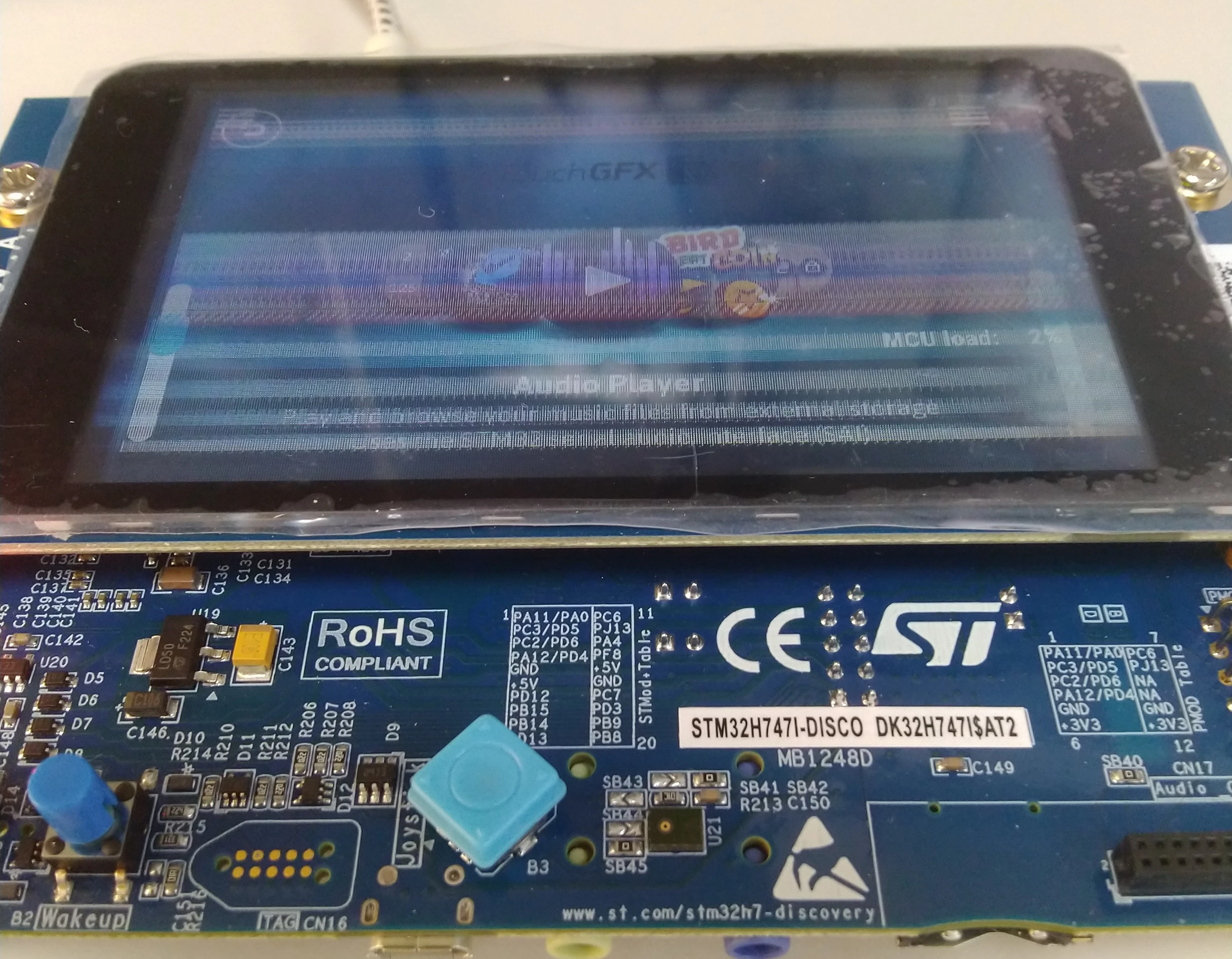

Hello all,

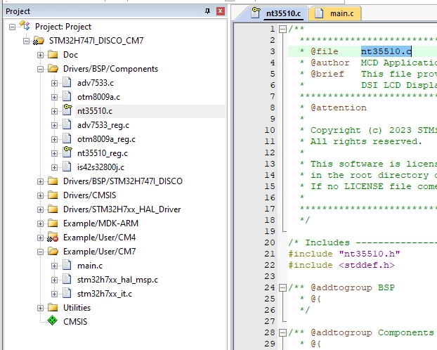

I have been trying to get the discovery board working in video mode with double buffering example working but have had no luck. I tried three different projects, the really old one from some release from two years ago, the 1.11.0 release, and the 1.11.1 release (a patch to the 1.11.0 release which seem to have added additional files relating to the display, i.e., nt35510.c, though I don't understand how this works since there's also the OTM8009A which I've copied from the previous release 1.11.1). None of these projects seem to give the expected behavior and frustratingly still results in tearing.
This is captured on my phone, what's shown below is played back at 960 FPS (I think, might be half of that). It seems to update the screen very quickly, faster than what my camera can capture, but bafflingly, does it in two diagonal halves.
If I understand the project correctly, once the buffer is prepared, the LTDC hardware is pointed to the address of the new buffer by a single change in pointer, and the LTDC runs continuously by scanning the buffer repeatedly and outputing the highspeed DSI data as it does not have a separate buffer. This change in pointer should be extremely fast.
What's also odd to me is that the buffers are initialized to an unexpected size and not 800*480*4 (resolution of the screen and 32 bits per ARGB8888 pixel).
Could someone please give some ideas of what's going on? Is this a driver issue? I also had no idea how to patch the 1.11.1 patch to CubeMX and had to manually patch it (generate new project using 1.11.0 and then add in the files to a project that's manually extracted from the 1.11.1 patch)
The demo seems to have no similar tearing problems so the hardware should be capable of generating a tearing free viewing experience.
(keywords for future people experiencing similar issues: LTDC, DSI, DISCO, NT35510, OMT8009A)

One of the following flags must be enabled in stm32h747i_discovery_conf.h file options in order to select the target daughter board revision connected on STM32H747I DISCOVERY :
- USE_LCD_CTRL_OTM8009A : Applicable for all LCD daughter boards (MB1166) except for Rev -A09/A03 , it is defined as follows :
#define USE_LCD_CTRL_OTM8009A 1U
#define USE_LCD_CTRL_NT35510 0U
- USE_LCD_CTRL_NT35510 : Applicable only for LCD daughter boards (MB1166) Rev -A09/A03 , it is defined as follows :
#define USE_LCD_CTRL_OTM8009A 0U
#define USE_LCD_CTRL_NT35510 1U

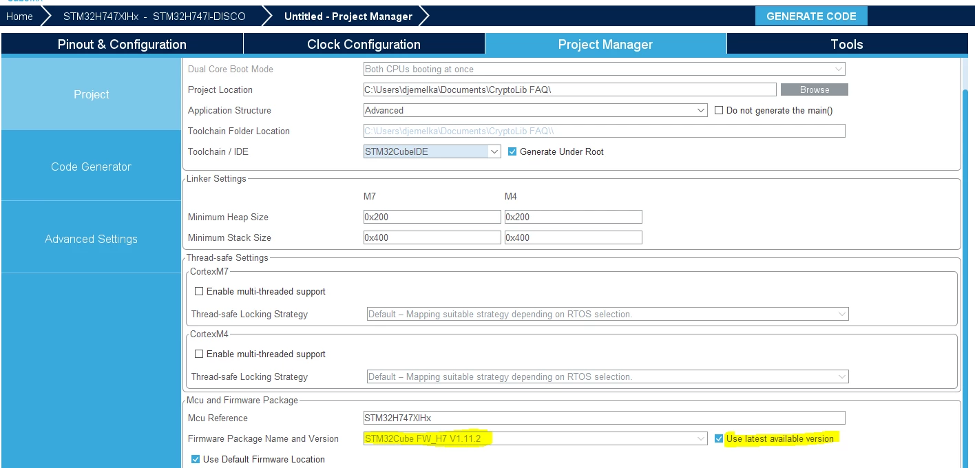

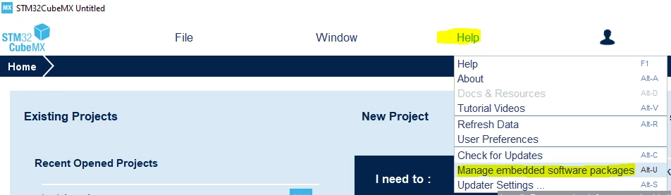

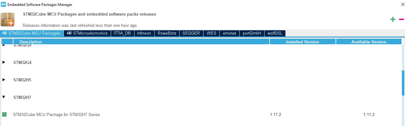

Could you please download and install the last version of STM32CubeMX, then click on help->Manage embedded software packages.
Then select STM32CUBE MCU package for STM32H7 Series version 1.11.2 and install it.

Hi KDJEM.1
Probably, your information is outdated. I have exactly the same issue with the newest CUBE-H7 (1.11.2) and set define USE_LCD_CTRL_NT35510 (actually, that define is of no use as it appears only once in the project - only in stm32h747i_discovery_conf.h). The main board is D03, the display board is A09, bought recently at mouser (with completely empty flash i.e. without demo firmware).
Also there is an issue with TouchGFX demo (tried compiled hex file and built from source as well).
Seems like the board/screen weren't fully tested as well as the examples (see the red line on the first screenshot - I had to correct main.c in order to bring it on the screen).

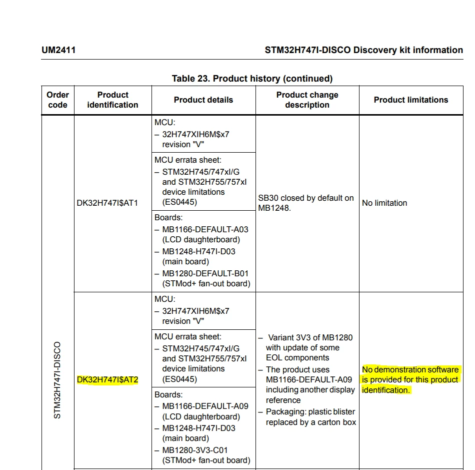

I reported LCD_DSI_VideoMode_DoubleBuffering example issue internally.
About the Demo, it is mentioned in UM2411, for DK32H747I$AT2 product identification, that No demonstration software is provided for this product identification.
Internal ticket number: 180253 (This is an internal tracking number and is not accessible or usable by customers).
Thank you.

I have this exact same graphical issue with my STM32F469I-DISCO DK32F469I$AU1 using the LCD_DSI_VideoMode_DoubleBuffering example for that board.
It appears not to be a new issue for that dev board (see below links), but it's still not fixed. I'm about to create my own ticket for the problem.
https://community.st.com/t5/stm32-mcus-touchgfx-and-gui/some-kind-of-tearing-effect-with-lcd-dsi-videomode/td-p/398477
https://community.st.com/t5/stm32-mcus-touchgfx-and-gui/stm32f469i-disco-screen-tearing-on-double-buffer-example/m-p/668979#M37372
May 5, 2024
Yes, I have seen these. Seems like that display is of poor quality or DSI peripheral is poorly designed (sort of incompatibility or whatever). That is crazy, change of the frame address causes so slow picture update, easily visible with the naked eye, whereas it should be instantaneous.

To avoid the tearing issue, could you please try to use a portrait mode or a partial refresh with landscape mode based on LCD_DSI_CmdMode_PartialRefresh
May 8, 2024
Hi. Thank you.
It's all right with a portrait mode. But I am really interested in landscape video mode.
