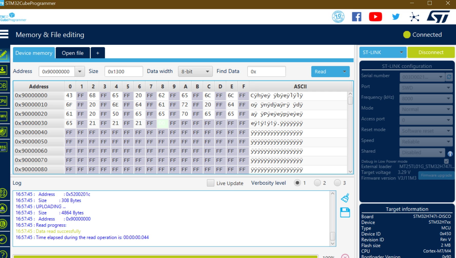

Hi everyone,
I’m working with the STM32H747I-DISCO board and its onboard QSPI flash (Micron MT25QL512ABB). I’m encountering a frustrating issue:
 Problem:
  • Writes to even addresses (e.g., 0x90000000, 0x90000002) work perfectly.
  • Writes to odd addresses (e.g., 0x90000001, 0x90000003) either fail silently or corrupt data.
What I’ve tried:
  1. Configured QSPI in 1-line and 4-line modes (with/without Memory-Mapped Mode).
  2. Ensured sector erasure (4KB) before writing.
  3. Used both PAGE PROGRAM (0x02) and QUAD PAGE PROGRAM (0x32) commands.
  4. Verified signals with an oscilloscope (no obvious timing issues).
  5. I am using this sample codes: https://github.com/STMicroelectronics/stm32-external-loader/tree/contrib/QSPI_Drivers/MT25QL512
Questions:
  1. Is this a hardware limitation of the QSPI flash or the STM32 controller?
  2. What’s the correct configuration to write single bytes to odd addresses?
  3. Should I force standard SPI (1-line) mode instead of Quad I/O?

I think the External Loader is looking at a pair of memories, or dual die TL part.
The banks alternate odd/even bytes
In single part mode you'll only program one part, the even one
Tesla DeLorean
Guru
Apr 4, 2025 5:36 PM UTC
They use the DUAL FLASH mode, so a pair of MT25QL512 or dual die MT25TL01G, allows for an 8-bit interface, higher bandwidth, achieved by alternating bytes between both, ie sends one command and you write a page of 512 bytes, rather than the 256 bytes for a single memory. Same for reads of status registers, reading a pair of bytes and waiting when either is BUSY or JEDEC READ ID, where you'd now read 6-bytes instead of 3
https://github.com/STMicroelectronics/stm32h747i-disco-bsp/blob/c11e85749f760a7ee35d12ff7ee79646de75e6db/stm32h747i_discovery_qspi.c
The External Loader for the H747I-DISCO presumes the paired devices. You could access a singular device loader, then it would see the data as you read it. There should be a workable loader on my github repo to access just the one device.

Sasa1234AuthorBest answer
Apr 7, 2025 1:06 PM UTC
Hi Guys,
I used our suggestion and I want to share my results............
I found this tutorial https://github.com/gokmez/STM32H7-Bootloader/tree/master but the mt25tl01g.h file is wrong....So I change it with https://github.com/controllerstech/STM32/tree/master/QSPI/MT25TLxxx and it works!!!!
