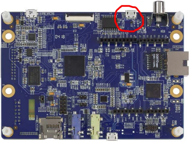

Hello, I just got STM32H747I-DISCO board. I have stlink-2 and I guess I cannot program this board with stlink2. Do I need to get STLink-3 or STLink-4 in order to program this board? In the description it says: Board has a built in STLink-v3 inside of it. Does it meanI " do not need an external programmer to program it"? If yes how will I do that without an external programmer. Thanks beforehand.
13 replies
berendi
Principal
January 15, 2020
Connect the USB port marked ST-Link V3 to your PC to access the built-in ST-Link
