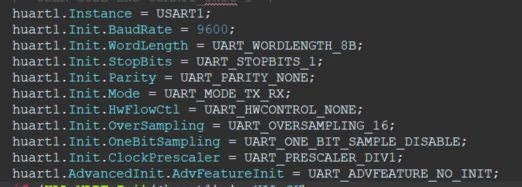

Below image shows my UART Initialization in main.c

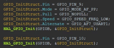

Below image shows the UART initialization in msp.c

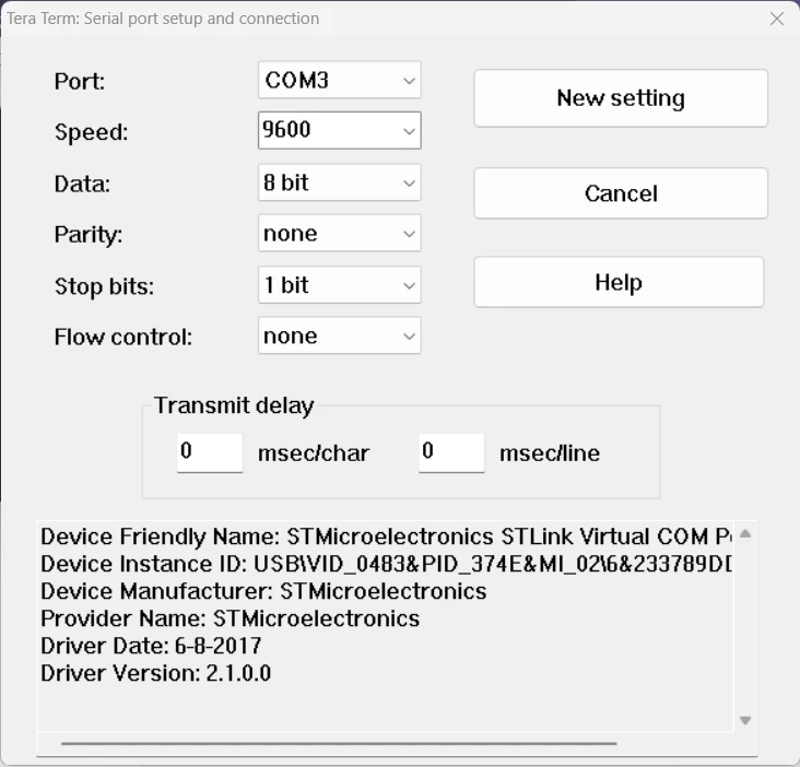

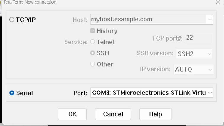

Below image shows the settings i made in Tera Term

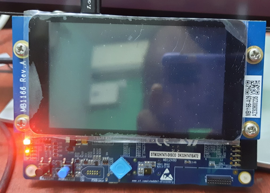

Below is the image of by board when executing the code.

The pins are on GPIOA not GPIOB

void HAL_UART_MspInit(UART_HandleTypeDef* huart) // Ensure right clocks, pins and peripheral
 RCC_PeriphCLKInitTypeDef PeriphClkInitStruct = {0};
 if(huart->Instance==USART1)
 /* USER CODE BEGIN USART1_MspInit 0 */
 /* USER CODE END USART1_MspInit 0 */
 /** Initializes the peripherals clock
 PeriphClkInitStruct.PeriphClockSelection = RCC_PERIPHCLK_USART1;
 PeriphClkInitStruct.Usart16ClockSelection = RCC_USART16CLKSOURCE_D2PCLK2;
 if (HAL_RCCEx_PeriphCLKConfig(&PeriphClkInitStruct) != HAL_OK)
 Error_Handler();
 /* Peripheral clock enable */
 __HAL_RCC_USART1_CLK_ENABLE();
 __HAL_RCC_GPIOA_CLK_ENABLE();
 /**USART1 GPIO Configuration
 PA9 ------> USART1_TX
 PA10 ------> USART1_RX
 GPIO_InitStruct.Pin = GPIO_PIN_9|GPIO_PIN_10;
 GPIO_InitStruct.Alternate = GPIO_AF7_USART1;
 HAL_GPIO_Init(GPIOA, &GPIO_InitStruct);
 /* USER CODE BEGIN USART1_MspInit 1 */
 /* USER CODE END USART1_MspInit 1 */

SKuma.49
SKuma.49Author
October 31, 2023
It Works!!!
Thank you, Tesla DeLorean,
I changed the port to GPIOA in all places related to UART as per your above code and now I am able to receive the data in putty.
