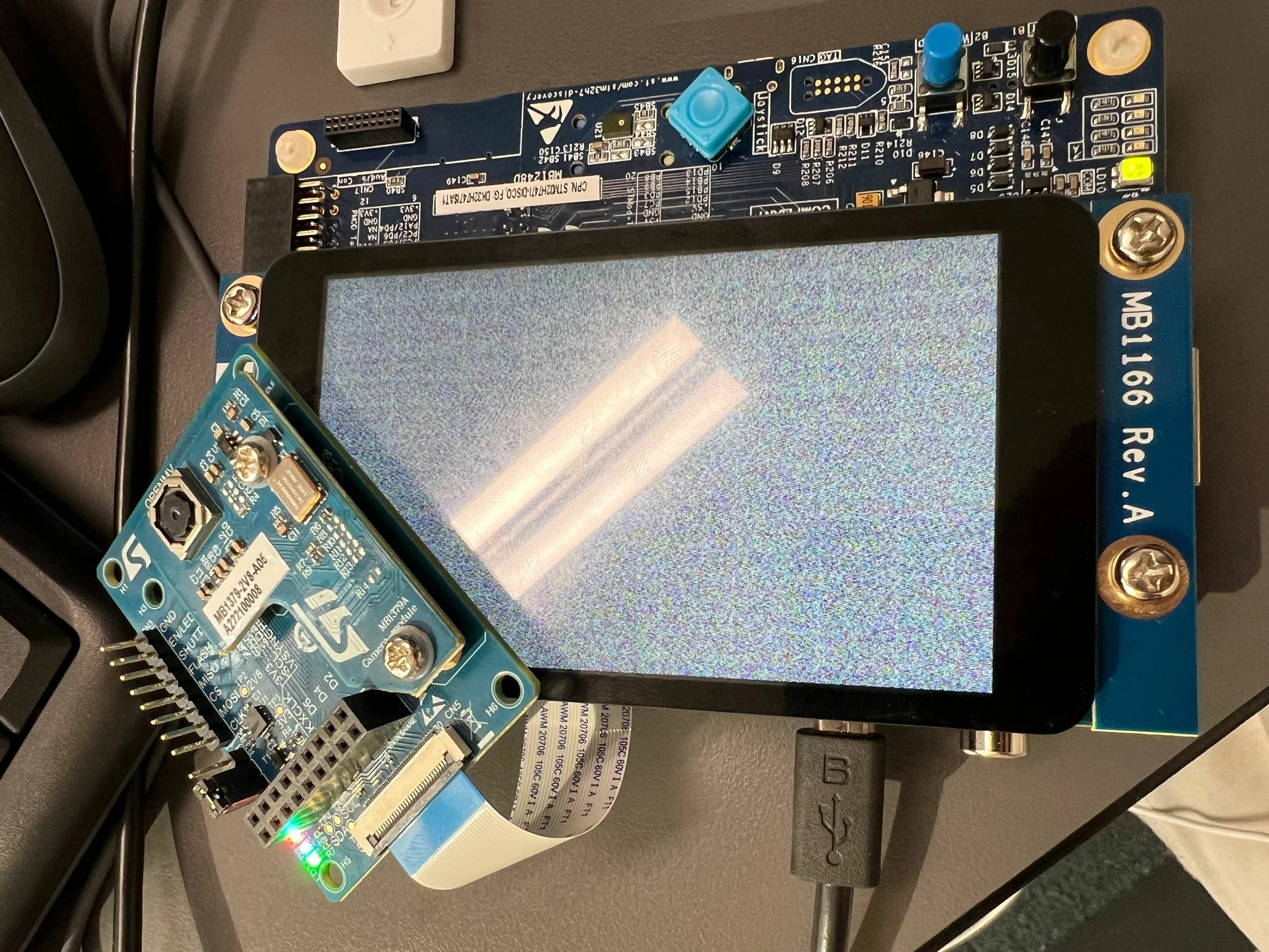

STM32H747I-DISCO + B-Cams-OMV cannot run webcam or People detect

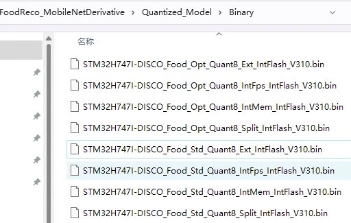

0693W00000aJ09tQAC.jpg*Using FP-AI-Vision1 Pack
import the binary webcam, the screen is black.
import the people detection binary, the screen is a mess.
No camera picture.
While import the Tutti Frutti demo, it can normally run.

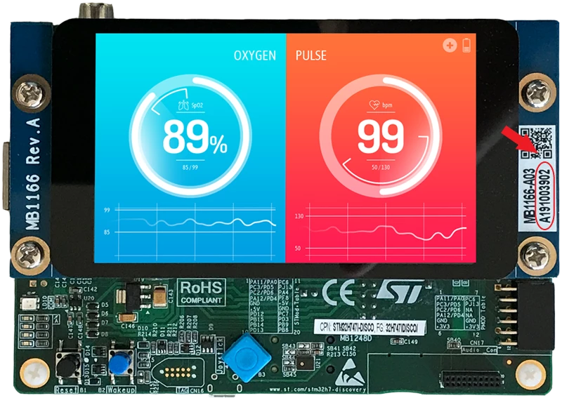

Which MB1166 Rev.A revision are you Using? A01, A03...?
You can find the MB1166 revision as shown in the below figure.
Thank you,
Kaouthar
Az.21
Az.21Author
Mar 15, 2023 3:29 PM UTC
Thanks for help! A03

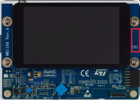

MOBEJ
May 3, 2023 11:10 AM UTC
Hello @AZ_it.2​
could you please give me the S/N (serial number) for your LCD , you can find how identify your SN on the picture below ,
_legacyfs_online_stmicro_images_0693W00000bjHktQAE.pngThank you

Hello ,
The fix is available on GitHub :
https://github.com/STMicroelectronics/STM32CubeH7/commit/1c84713102f8509deb79ae14db8dbb104c17c45e#diff-8a5b12f7040dfb560c495dc0a1213725ba939bf19d531dd1e97067b6a1a79ec0
In fact , LCD DSI MB1166-A9 delivered with latest version of STM32H747I-DISCO/ boards come based on LCD FGRIDA FRD400B25025-A-CTK instead of FRD397B25009-D-CTK.
Now the firmware is updated , you just need to enable the right hardware component as defined in stm32h747i_discovery_conf.h file and add the new component library (NT35510) in your project .
/* IMPORTANT: One of the following flags must be enabled in stm32h747i_discovery_conf.h file */
/* options in order to select the target daughter board revision connected on STM32H747I DISCOVERY : !!!!!!!!!! */
/* USE_LCD_CTRL_OTM8009A */ /* Applicable for all LCD daughter boards (MB1166) except for Rev -A09 */
/* USE_LCD_CTRL_NT35510 */ /* Applicable only for LCD daughter boards (MB1166) Rev -A09 */
