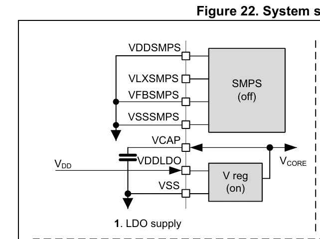

Hi, Im planning on using STM32H747BGT6 in LDO mode only and no USB interfaces will be used. What should I do with SMPS pins (VSSSMPS, VLXSMPS, VDDSMPS, VFBSMPS) and USB supply pins (VDD50_USB and VDD33_USB)? The datasheet nor the application note don't say much about what to do with these pins when not used.
Thanks in advance.

VDDSMPS, VFBSMPS, VSSSMPS to VSS, leave VLXSMPS floating.
STM32H745/755 and STM32H747/757 advanced Arm<Sup>®</Sup>-based 32-bit MCUs - Reference manual
Hook up VDD33_USB and VDD50_USB to VDD.
FAQ: Configuring the VDD50USB and VDD33USB pins on... - STMicroelectronics Community
