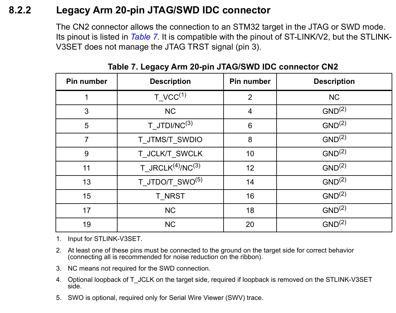

What is the TVAPP app pin? This doesn't appear in the V3SET user manual. Did you mean T_VCC? Assuming so:
If it's delivering 5V to the programmer, you have a hardware problem. That pin should be tied to VCC you're using on the MCU. If it's 5V, that explains why the chip isn't responding as voltage should be under 3.6V.

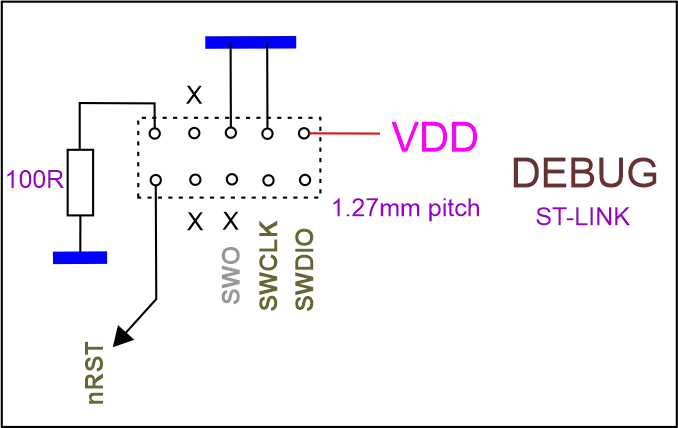

Here my SWD connector for an ST-LINK debugger.
The VDD is not provided by ST-LINK: it is a sense signal ("what is target VDD?") as well as the 100R to GND: "is there a connection?".

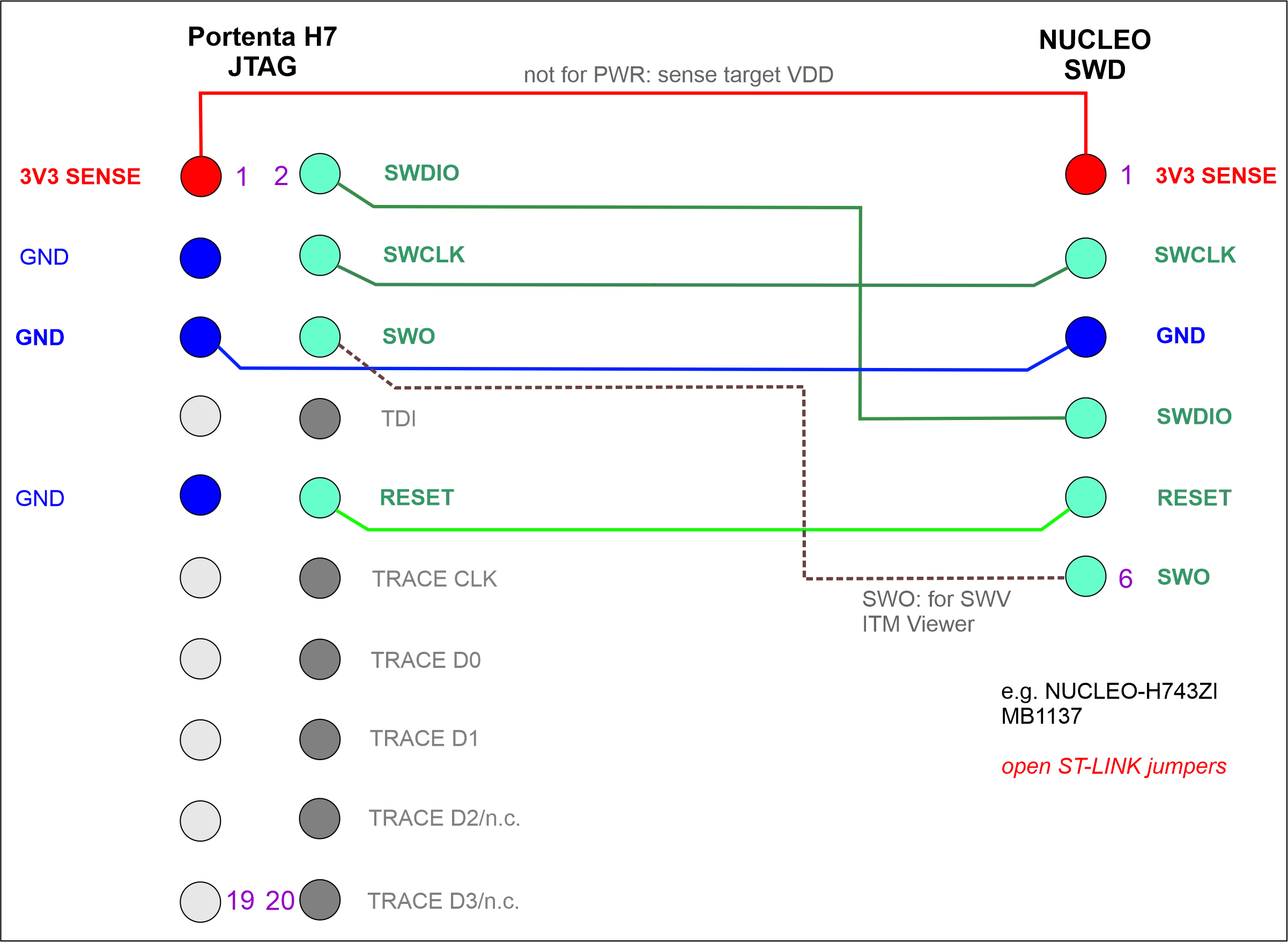

Bear in mind, that some SWD connectors on other boards (e.g. Portenta H7) can be a bit larger, for instances see here:
https://electronics.stackexchange.com/questions/595103/stdc14-connector-pinout-for-st-link-v3-for-swd-debugging
Find really the important signals, e.g. SWDIO and the VDD (3.3V) opposite to it. Do not rely on "pin 1", esp. if your connector is a bit larger as "usual", e.g. on Portenta H7:

Okay, so you have developed a custom board which is analogous to the H7 Portenta plus the Ethernet shield and you're using a JTAG port analogous to the port on said ethernet shield.
The ethernet shield "+3V3" line isn't tied directly to the MCU voltage. So that explains why it can be zero and still get programmed.

To your question of how does voltage sensing on the programmer work: On some programmers, the pin 1 (T_VCC) voltage is used by a level shifter to change the logic level of the signals. On the V3SET (without the logic shifter board), it is not used in this manner and the logic level stays at 3.3 V. The T_VCC voltage is just relayed to STM32CubeProgrammer to display. Otherwise it has no functionality and is not needed by the programmer (as evidenced by it still working while at 0V).
If your V3SET programmer really is putting +5V on pin 1, either the programmer is damaged, or perhaps the measurement is faulty. The programmer just doesn't work that way.
