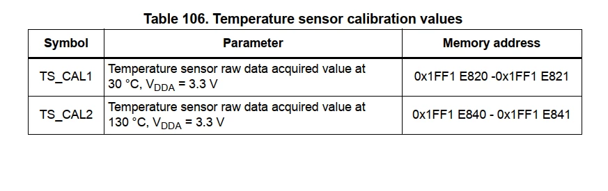

Hello, Friends,
I am using ADC(16 bit) to measure the STM32H747 Internal Temperature and VrefInt based on external reference voltage (VDDA 3.3V, Vref+ 2.5V). The VrefInt result is 1.221V, which looks good. However, the temperature result is 150C, which seems not correct.
From the STM32H747xl/G datasheet, there are temperature sensor calibration values TS_CAL1(30C) and TS_CAL2(130C). The formular to get real temperature is (130-30)*(myADCValue-TS_CAL1)/(TS_CAL2-TS_CAL1)+30.
Here are my questions: 1) Is the formular correct? 2)Which reference voltage value is used when TS_CAL2/TS_CAL1 values are read during the calibration? I am using 2.5V external voltage in my design.

> (100 * ((ts_data*33/25) - ts_cal1)) / (ts_cal2 - ts_cal1) + 30 = 291 C
Should be
(100 * ((ts_data*25/33) - ts_cal1)) / (ts_cal2 - ts_cal1) + 30 = 45 C
45 C seems right.

Thank you for the reply. I am pretty sure my ADC set up is OK because it gets correct VrefInt  values(1.221V) now. My main concerns are those temperature calibration values from the data sheet. Are they based on some internal reference voltages (2.5/2.048/1.8/1.5) during the calibration measurement?  My ADC design is using 2.5V external voltage(VREFBUF_CSR setting is 0x02, HIZ =1, ENVR = 0). I am guessing the ADC reference voltage makes the difference.

Hmm, yes you are right I think - if Vref is not 3.3V, then you will most likely need to do some scaling.
When I did it, I'm pretty sure I had Vref tied to 3V3.
RM0433  Page 992 of the manual is a little vague to say the least, but TS_CAL1/2 are measured with Vref at 3V3 as far as I can tell.

TS_Cal1_New=TSCal_1*Vref/3V3.
There could of course be an offset to apply as well...
July 29, 2024
It should be stated better, but they're taken with VREF+ = VDDA. The specification on VDDA is 3.3 V +/- 10 mV per the datasheet.
