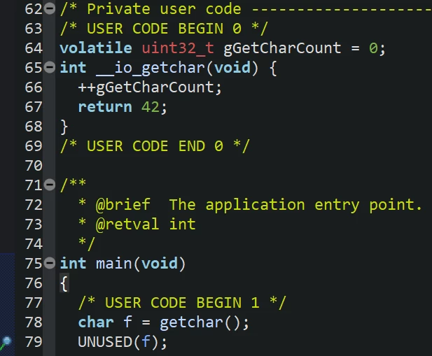

Hi Guys,
This is driving me mad!
So this works perfectly echoing characters via uart8:
int ch = 'A';
while (1)
 HAL_UART_Transmit(&huart8, (uint8_t *)&ch, 1, 0xFFFF);
 HAL_UART_Receive(&huart8, (uint8_t *)&ch, 1, 0xFFFF);
Now if I have getchar and put char implementations:
#define PUTCHAR_PROTOTYPE int __io_putchar(int ch)
#define GETCHAR_PROTOTYPE int __io_getchar(void)
PUTCHAR_PROTOTYPE
 return ch;
GETCHAR_PROTOTYPE
	uint8_t ch;
	__HAL_UART_CLEAR_OREFLAG(&huart8);
	HAL_UART_Receive(&huart8, &ch, 1, 0xFFFF);
 return ch;
The following does not work, we do not get anything received and get stuck in UART_WaitOnFlagUntilTimeout() called from HAL_UART_Receive() from __io_getchar():
 while (1)
 ch = getchar();
However if I directly call __io_getchar() everything works perfectly, UART data is received:
while (1)
 ch = __io_getchar();
Has anyone any idea why __io_getchar() called directly is working and when called indirectly it isn't, no UART data?
Cheers
Andy

With this code:

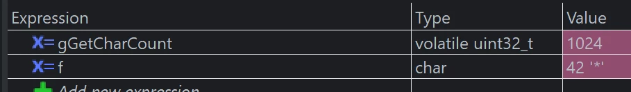

We get this after one getchar() call:
You can set the input to unbuffered to get only a single call.
setvbuf(stdin, NULL, _IONBF, 0);
4 replies

Input is buffered, so when you request a char, it reads a large number of inputs (in this case, 1024), before giving you the one you requested.

Hi @TDK
Thanks so much, that was driving me mad!
