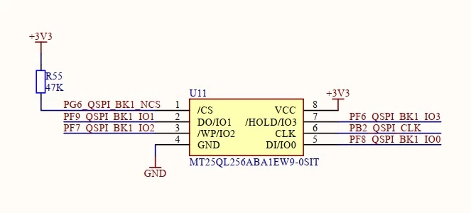

I designed custom board for stm32h745xit6 .
My TouchGFX working fine with internal flash .
_legacyfs_online_stmicro_images_0693W00000dDVHoQAO.pngThe core board has mt25ql256a and connected as under
PB2 CLK
PG6 NCS
PF8 D0
PF9 D1
PF7 D2
PF6 D3
I generated STLDR as explained in ST videos tutorial.
my generated STLDR file is visible and selected as external loader , but it gives error when programming 0x90000000 ...

You've also contacted me privately. If the ones I've built aren't functioning, I'll need to work on them some more. Not sure how much time / resources I can commit to that immediately.
What you can do, is write your own BSP and prove that the QSPI implementation that you have is viable. That you can read, write, and erase from application space, in a manner that you can debug and instrument to validate design level functionality.
https://github.com/cturvey/stm32extldr/tree/main/h7_mt25q256

Hello @INaee.1
I was wondering why I couldn't see your attached screenshots, I guess.
Overall, the flash loader for the MT25QL256A would need to be designed to handle the specific characteristics and requirements, including its size, timing parameters...

Hi ..
The problem was solved since I managed to develop my own ex-loaders .

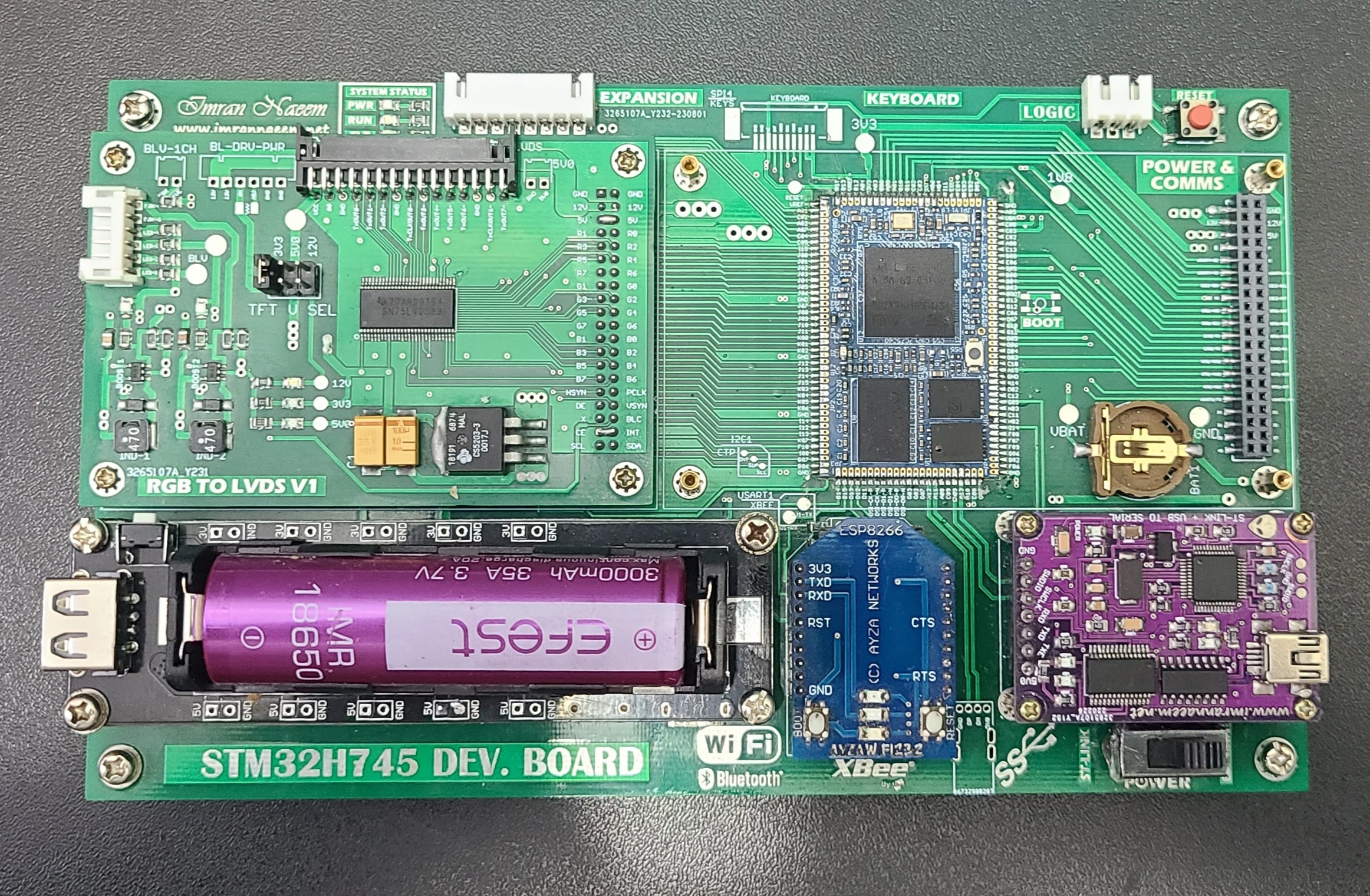

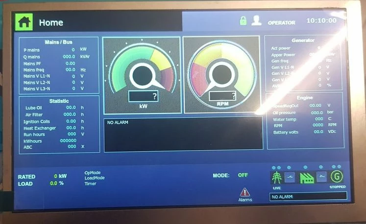

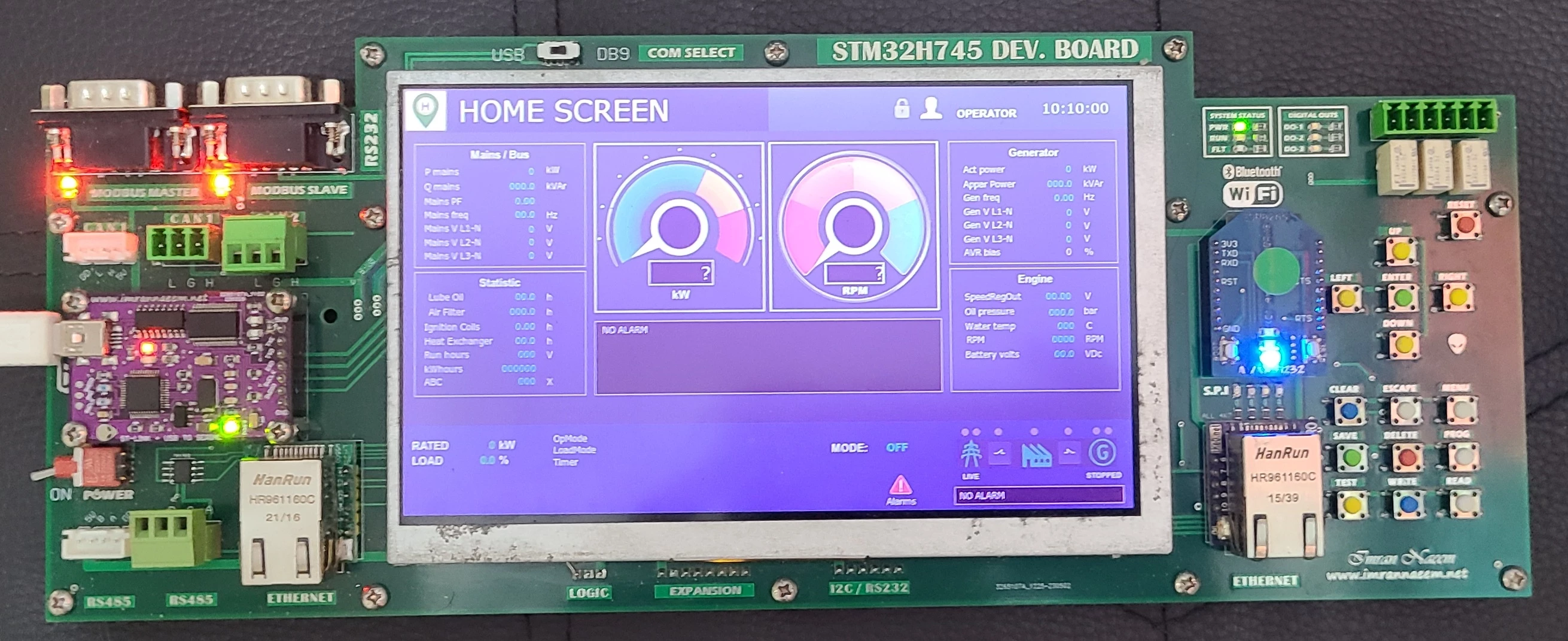

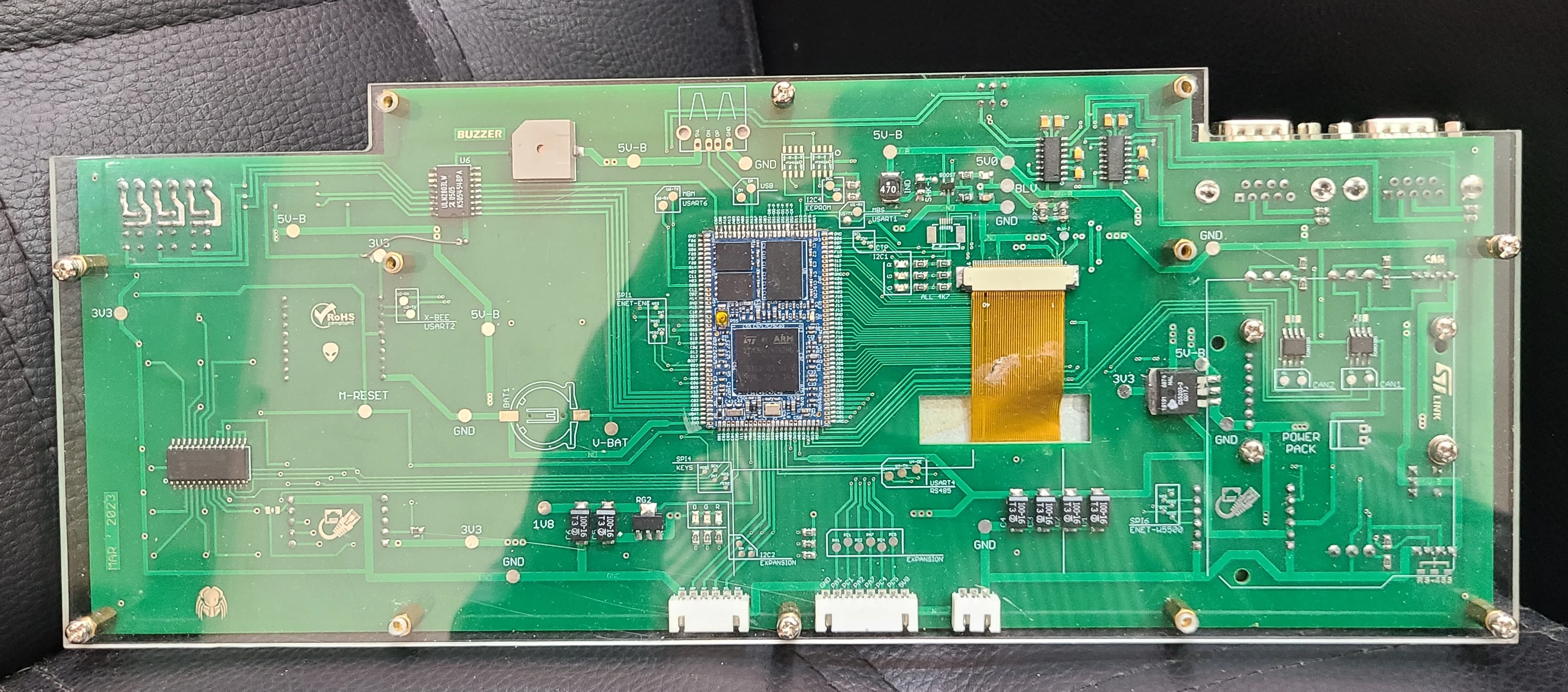

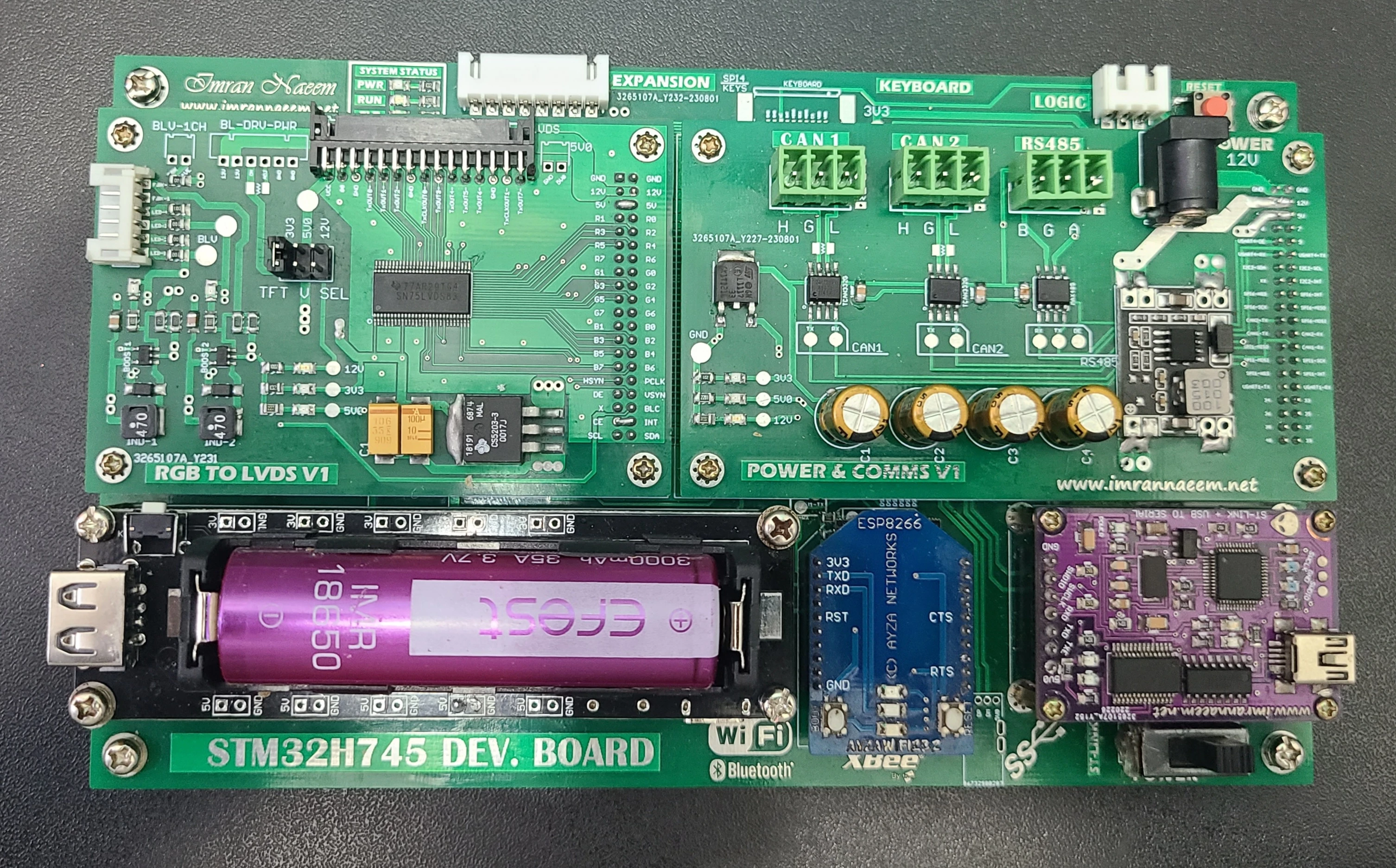

Here is my custom designed board with STM32H745XIT6 & 1024X600 RGB TFT with TouchGFX.

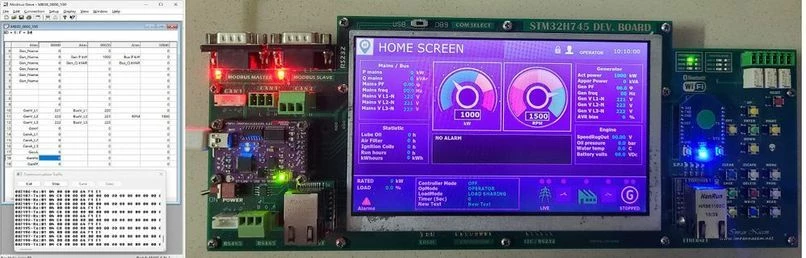

CM4 running Modbus Master RTU
CM7 running TouchGFX with 256MB SDRAM

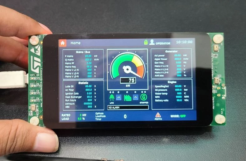

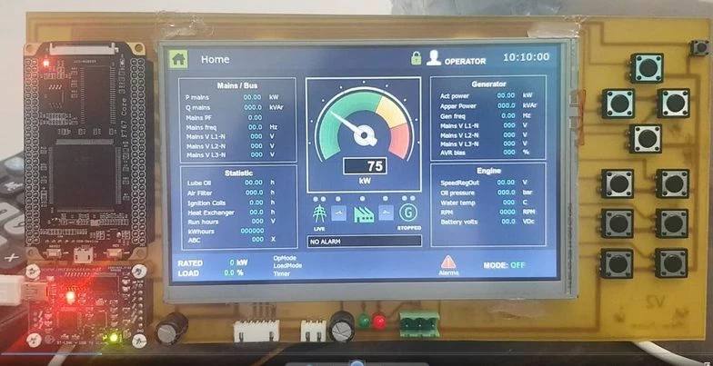

Here is TouchGFX , running on SAMSUNG TAB3 7.0 ,, 1024x600 , LVDS LCD (STM32F429i-DISCOVERY + SN75LVDS83B) :

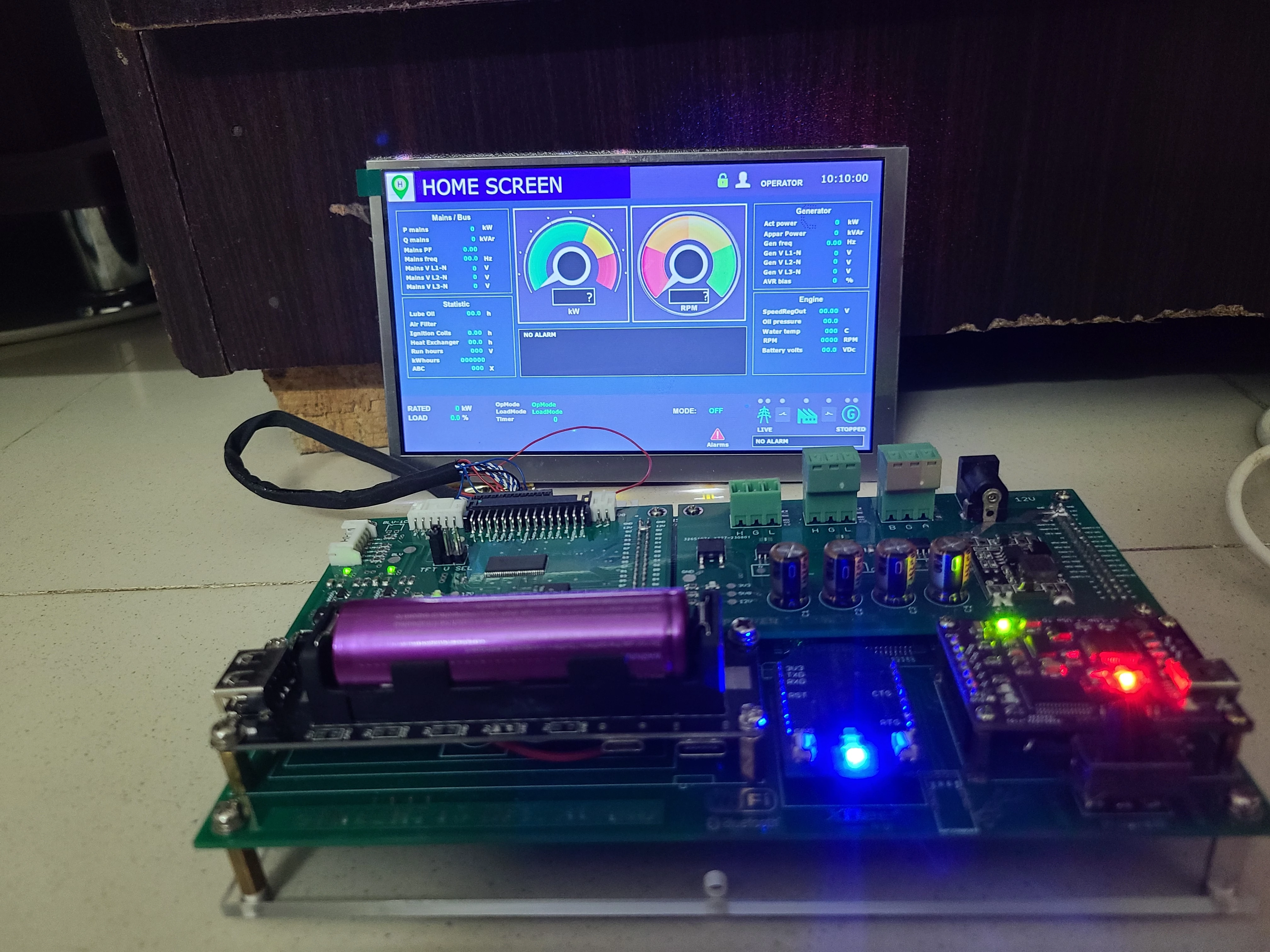

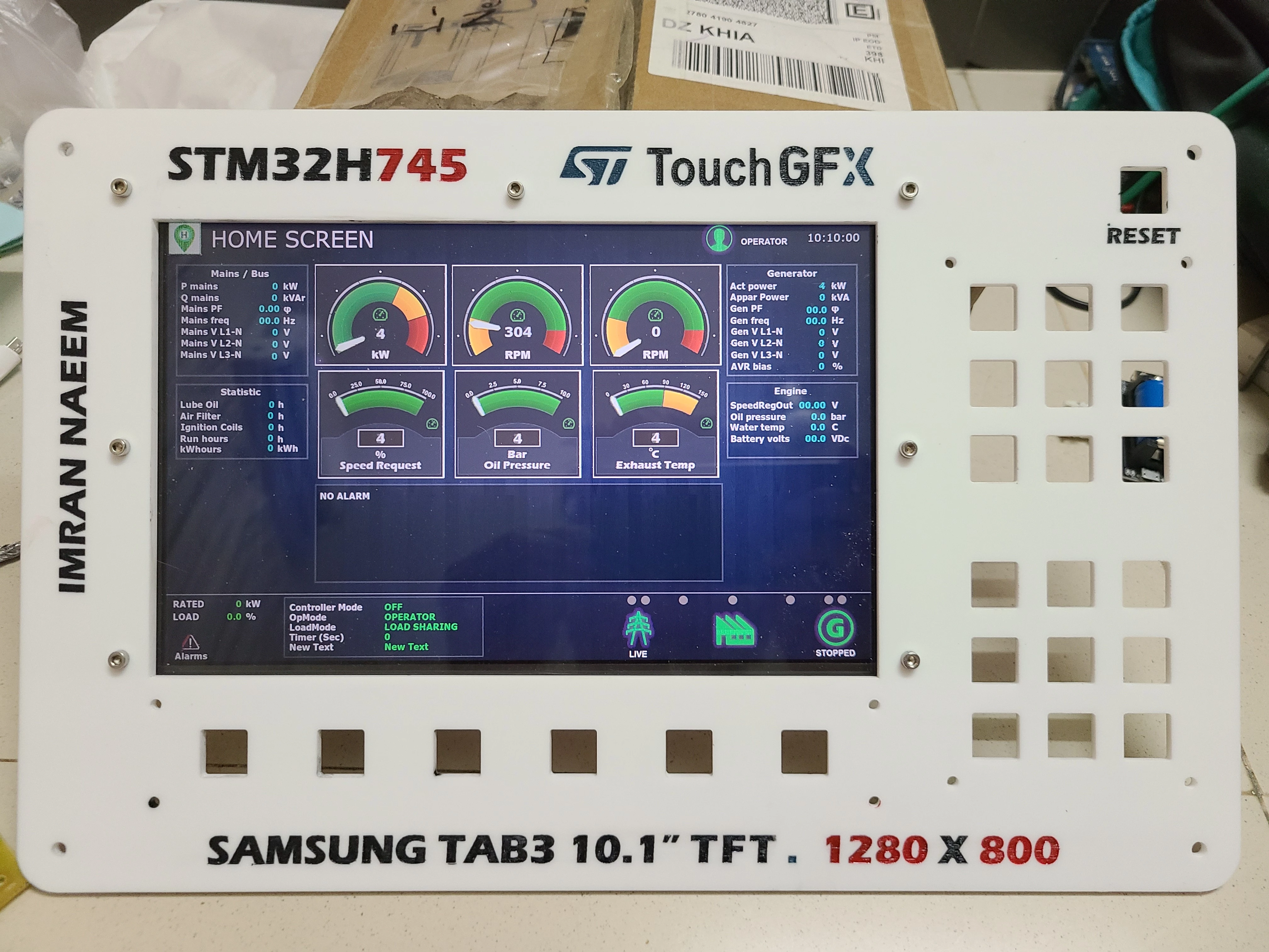

Here is my new version custom designed board with STM32H745XIT6 with add-on cards for different types of lcds like LVDS , RGB , HDMI , DVI , VGA .
Presently RGB TO LVDS card is fixed on left side with SN75LVDS83B (RGB to LVDS Bridge chip)20230811_104031.jpg20230811_104211.jpg

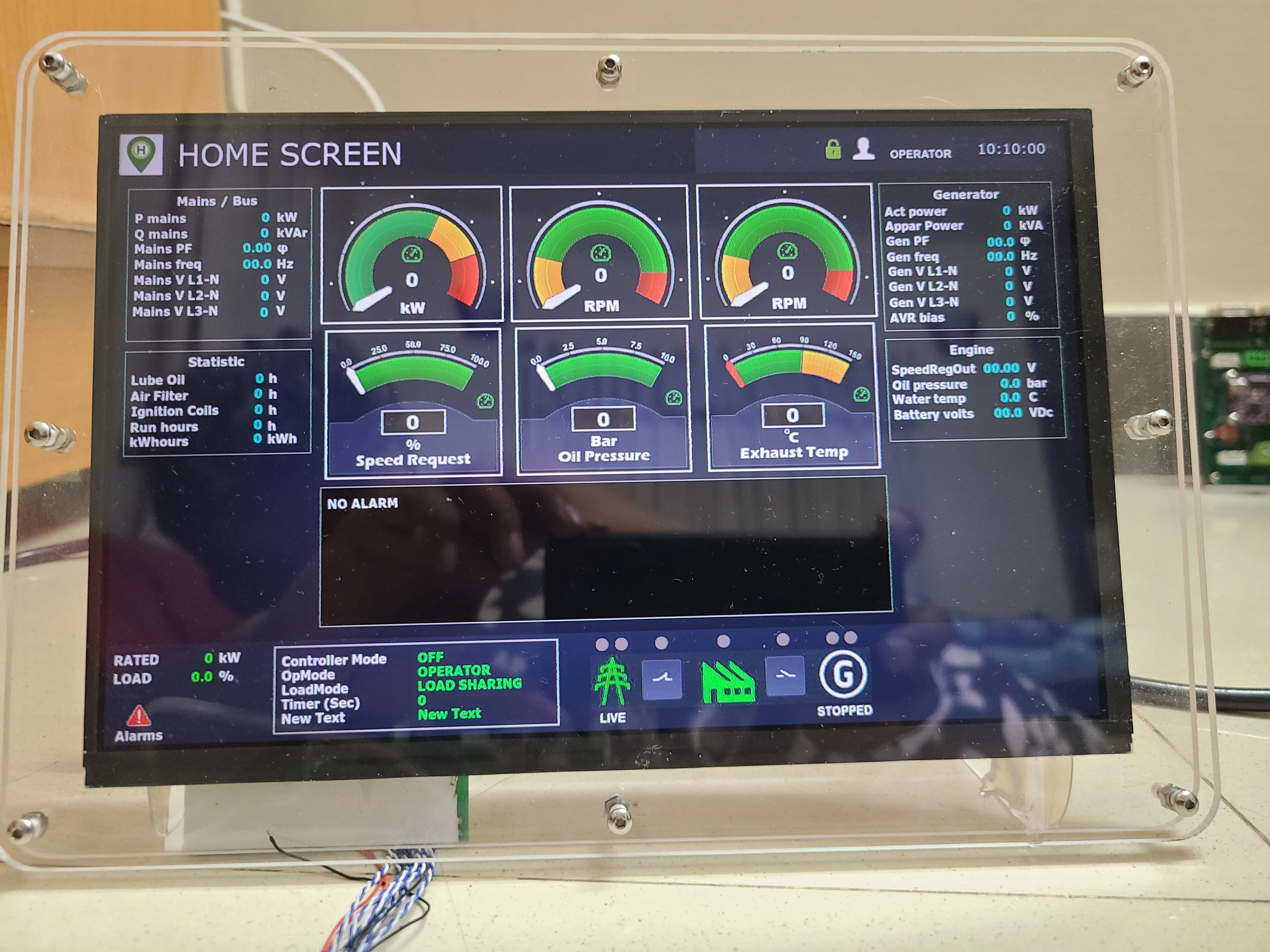

Here is TouchGFX , running on SAMSUNG TAB3 10.1 inch ,, 1280x800 , LVDS LCD (STM32H745XIT6 + SN75LVDS83B)
Its running on same above board which I developed 3 weeks ago ..
Below are the links of videos of above TouchGFX experiment.
https://www.mediafire.com/file/79gpetsru2srbcb/WhatsApp_Video_2023-08-26_at_12.15.12.mp4/file
https://www.mediafire.com/file/0m1cr4td9eza1r6/WhatsApp_Video_2023-08-26_at_12.15.15.mp4/file
Above project is under development , just quit busy and couldn't spare time to finish above development.

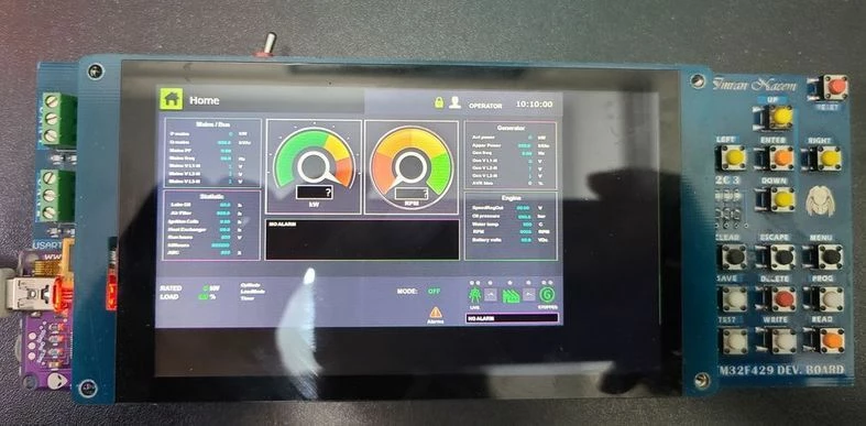

Here is TouchGFX , running on CHINESE 800X480 TFT (DE Mode) (STM32F767 WILDFIRE BOARD)
Tested Modbus on it with same usb cable coz I developed st-link board with usb hub chip and ft232rl. (Power + SWD + USB232/modbus)

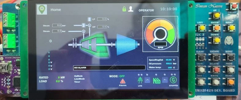

Here is TouchGFX , running on 5.0" ,, 720X1280 ,, RGB + SPI TFT with STM32F429i-DISCOVERY on back side.
LCD PART No. TL050HDV31CT5-H1206A
The lcd driver chip/COG is NV3052
Here is TouchGFX , running on 5.0" ,, 800X480 ,, RGB TFT with STM32F429i-DISCOVERY on back side.
Here is TouchGFX running on STM32F469i-DISCOVERY

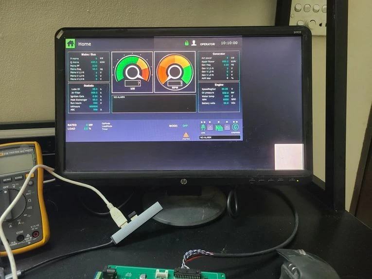

Here is TouchGFX running on HP S1932 18.5" Monitor's LVDS LCD with 1366x768 resolution .
The lcd part no. is LTM185AT04 or Equivalent . The driver is STM32F429i-DISCOVERY + SN75LVDS83B
Tested following lcds.
SAMSUNG TAB3 7.0" , 1024x600 TFT
THINKPAD T400 14.1" , 1280x800 TFT
GENERIC TFT MONITORS , from 14.1" to 18.5" Maximum tested resolution is 1366x768 TFT
Next Experiment with HDMI FHD i-e 1920x1080 TFT
I hope . You will admire my work ..
regards
I.N
