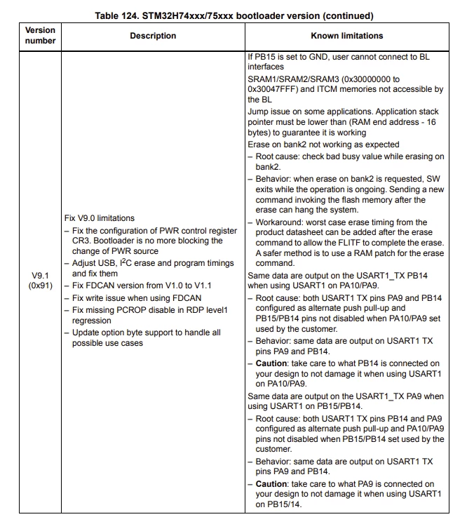

  1. Has anyone successfully jumped to the system bootloader on STM32H745XI purely by C code (no BOOT0/OB change), and if so, how?
  2. Is there any undocumented, low-level trick (register hack, RAM/stack/clock/secure config, etc.) to force bootloader entry, or is it silicon-level blocked?
  3. Why exactly does the function pointer jump method (as used in STM32F4/F7/L4, and sometimes H747) fail on H745XI? Is there an internal hardware barrier at reset/boot?
  4. Are there any real-world solutions beyond changing Option Bytes (which I can do, but would like to avoid for safety reasons)?
Notes:
  • PB15/PB14 pins are floating and not connected, so no TX damage risk.
  • If I brick the MCU, I can recover via SWD/JTAG or CubeProgrammer, so I am open to any risky/experimental ideas.
  • Any direct practical experience from someone who actually achieved this on STM32H745XI (not just theory or F4/F7 tricks) would be extremely valuable.

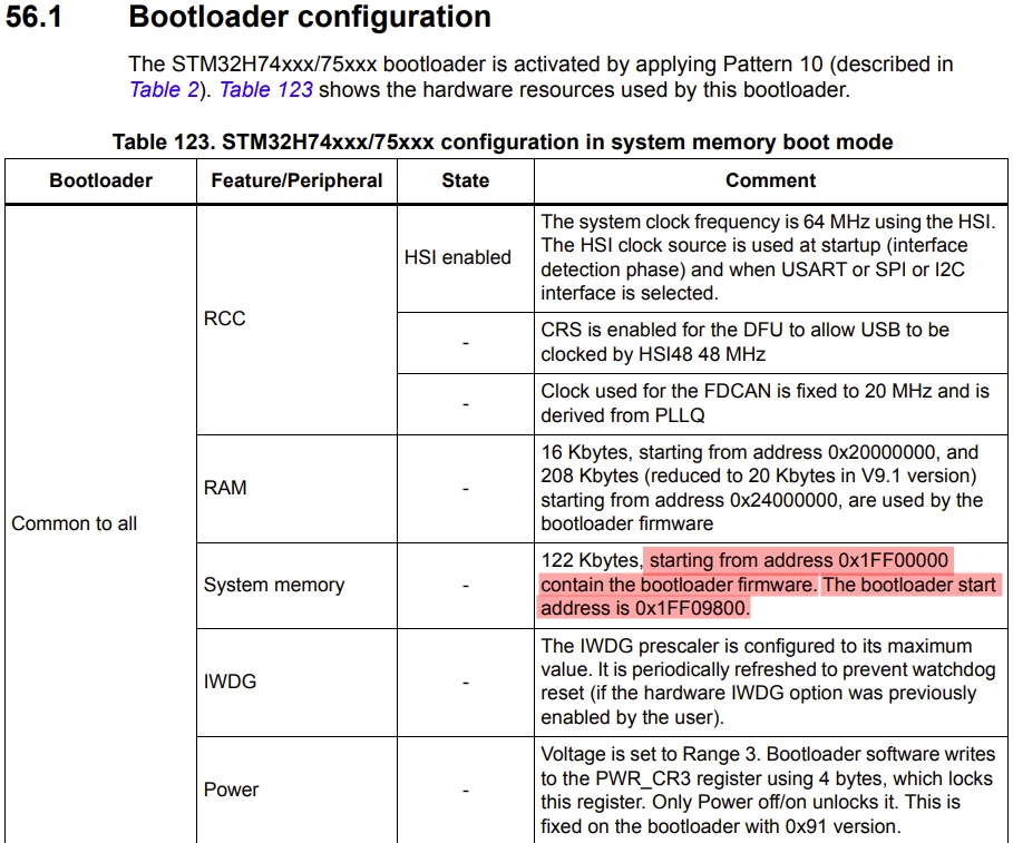

References:
  • Reference Manual Table 123 and Table 124 (bootloader address 0x1FF00000, entry 0x1FF09800, V9.1 limitations).
  • Datasheet: "Jump issue" and "boot mode is only checked at reset."

The STM32H745XI ROM bootloader (v9.1) relies on PLL2 and PLL3 being completely disabled, caches and interrupts properly cleared, and RCC restored to default states before initialization. If these steps are performed out of order or skipped, the bootloader UART handshake (USART1) will fail to initiate, causing the bootloader to become unresponsive.
Adhering strictly to the above sequence guarantees that the bootloader consistently initiates and functions correctly every single time.
