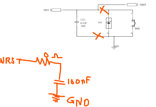

I'm experiencing an issue with my STM32 microcontroller (STM32h745iik6 own board) where it doesn't execute the code upon power up. However, when I press the reset button, the code executes as expected. I'm looking for some guidance to resolve this problem.
bellow i attach some schematic. please suggest how can i solve this challenges.

Please place a capacitor of approx. 100nF between NRST and GND.

hello @Peter BENSCH @mƎALLEm ,
I trying to 1) place 100nF/25v cap near nsrt
2) i try to disconnect all and only place 100nF cap with GND like below
but even not work.
3) if i disconnect reset ckt  so nsrt pin present 3.263v.. and just i touch any cable to nsrt then controller reset and code execute well.. ......
So actually what is issue.. any pull up/ pull dawn needed to add externally.

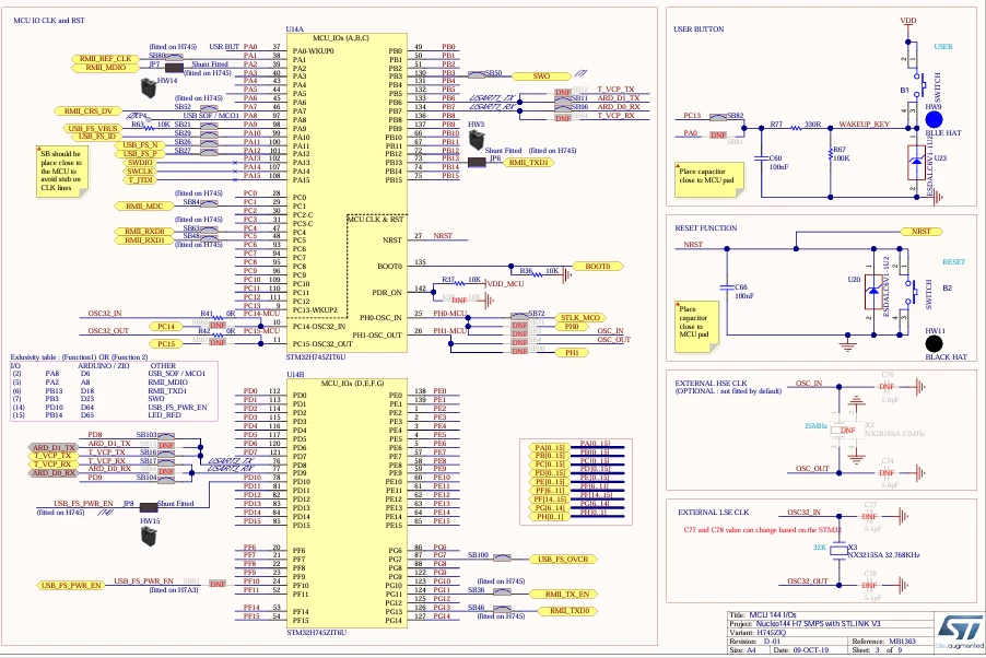

4) on Boot0 pin connection like below
add 1uf/25v cap to Boot0 with 3.3v and 10k gnd
my board upload program by external stlinkv3 programmer...  if i remove 1uF cap of boot0 then error while upload code...    but if i connect like above then program upload successfully... and debug also.. but i remove stlink then code not execute until i press nsrt every power up.

It is definitely wrong to place a capacitor from BOOT0 to VDD. Similarly, no pull-up is necessary at NRST, even if it is incorrectly shown in some colourful "Pills".

With the current information, this is difficult to assess. It could be a layout problem, one with the solder joints of your UFBGA, and so on.
If you touch the open NRST pin with your finger, you only inject noise, which trigger the same thing as a short low pulse.

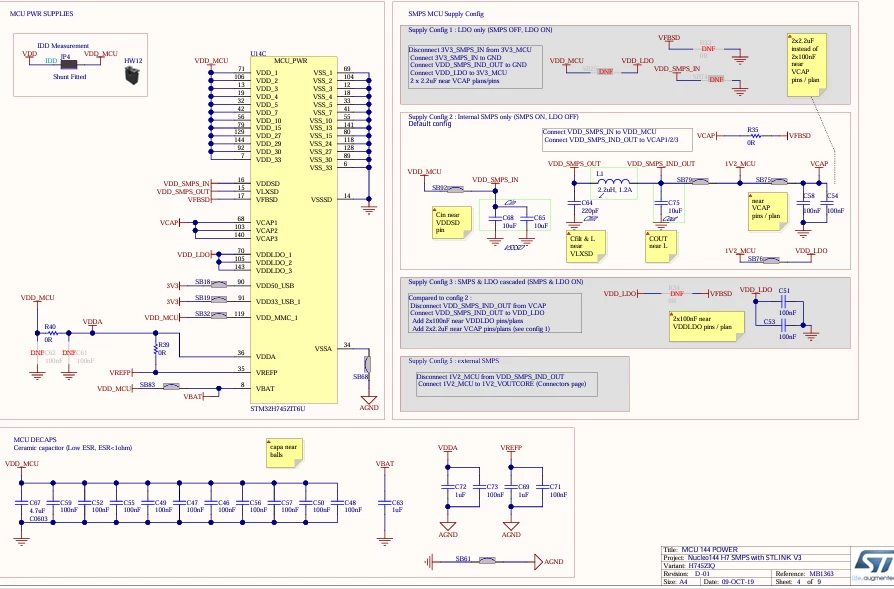

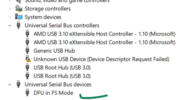

I want code run by default when power on. Now it detect usb dfu boot mode by default. and i'm able to upload code using usb dfu without touching boot pin. but all time i need to manually press reset button for going in user_application mode. means i power on the board i need to press reset then code run. bcoz it going in usb dfu mode by default when power on.
I attach schematic file below for your reference. Please suggest my what I'm wrong.
I refer the schematic file of board Nucleo-H745ziq NUCLEO-H745ZI-Q - STM32 Nucleo-144 development board with STM32H745ZI MCU, SMPS, supports Arduino, ST Zio and morpho connectivity - STMicroelectronics

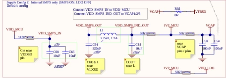

For supply configuration i'm using below,

dplogiicAuthor
Aug 7, 2024 4:32 AM UTC
Hello @Tesla DeLorean ,  The vectors are correct. I think power configuration issue. can you suggest me which is right LDO or DIRECT SMPS ? Can you suggest me for ioc? or any hardware changes i need to do.
