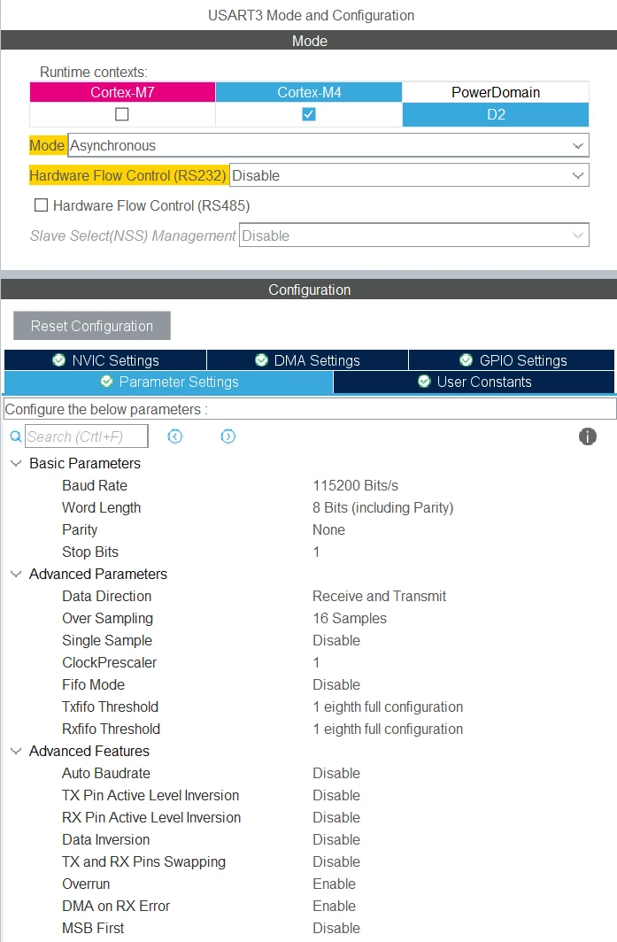

I have a STM32H745I-DISCO board that I would like to debug using UART Serial over the STLINK virtual com port. UM2488 Section 6.14 shows this should be connected to USART3.
I have the USART3 peripheral enabled with the following configuration:0693W00000JORC3QAP.png
In the main function, I have:
uint8_t buf[32] = "Hello!!"
and:
 while (1)
 HAL_UART_Transmit(&huart3, buf, strlen((char*)buf), HAL_MAX_DELAY);
 HAL_Delay(500);
I have ensured that the STLNK VCP driver is installed, and I see the COM port in my device manager window.

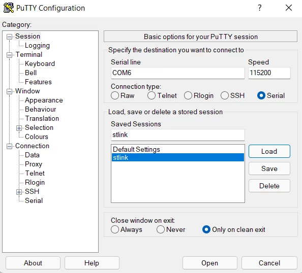

I connect to the port with the following settings in PuTTY:
0693W00000JOR6pQAH.pngThe terminal connects, but I don't see my output string.

Hello @woozl​
Have you configured GPIO associated to USART3 TX and RX ?
According to UM2488, Table 16, it looks like PB10 and PB11 are used.

Thanks for the reply, the pins have been configured as so:0693W00000JOSF3QAP.pngJust tried that example and had no luck either.

Look at the code generated, especially pins and clocks.
Make sure the HSE clock is correctly reflected in HSE_VALUE.
Do it on the CM7 core first.

Switching it to the CM7 core worked for some reason. Thanks!
