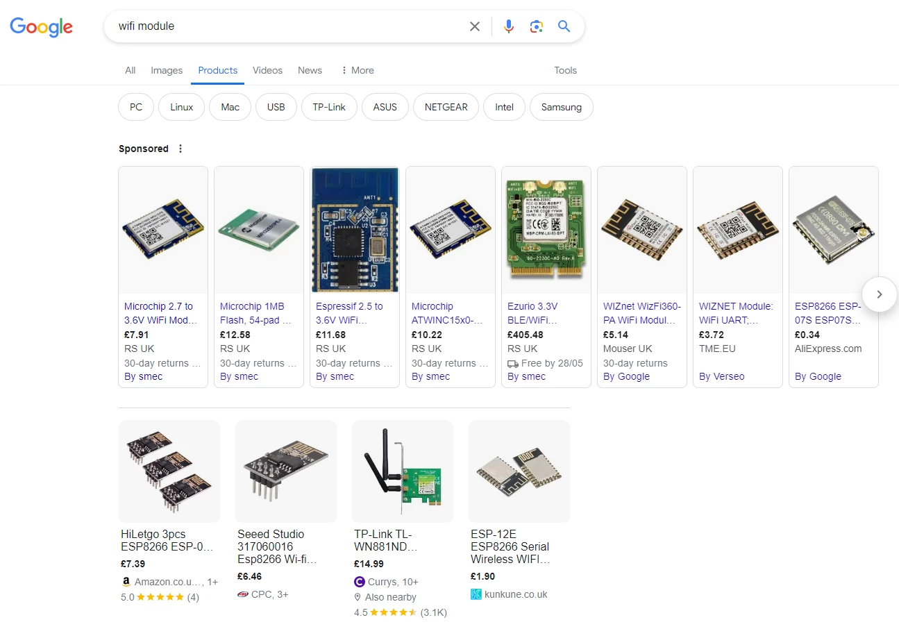

Andrew Neil
May 21, 2024
There are many WiFi modules available on the market, with a variety of standard interfaces - UART, SPI, etc ..
eg, only yesterday:
https://community.st.com/t5/stm32-mcus-wireless/connecting-stm32f7-disco-board-to-wifi-network-using-esp8266/m-p/676684#M19151
