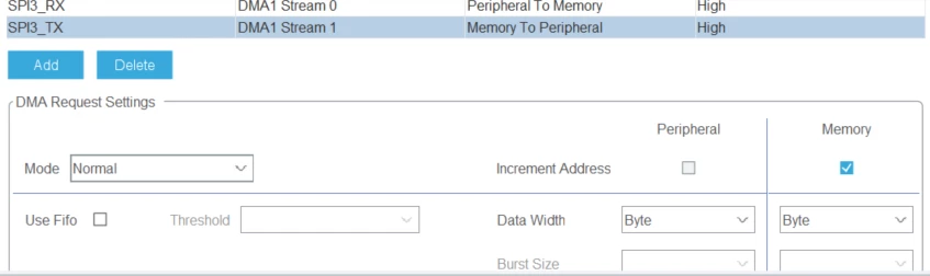

__silardgAuthor
February 12, 2024
I figured out that if I put a
while(hspi3.State != HAL_SPI_STATE_READY) {}
before the DMA transmission, it stays there and it blocks it. Why can this happen?
const uint8_t aTxBuffer[] = "****SPI - Two Boards communication based on IT **** SPI Message ********* SPI Message *********";
#define BUFFER_ALIGNED_SIZE (((BUFFERSIZE+31)/32)*32)
//ALIGN_32BYTES(uint8_t aRxBuffer[BUFFER_ALIGNED_SIZE]);
uint8_t aRxBuffer[BUFFERSIZE];
I'm doing receive like this
HAL_SPI_Receive_DMA(&hspi3, aRxBuffer, BUFFERSIZE);
