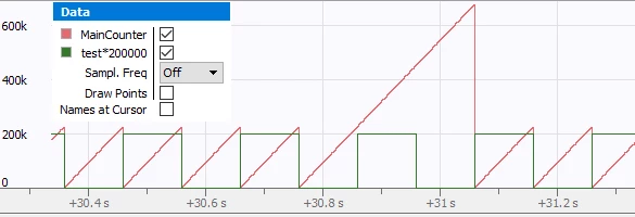

I have a strange problem. I have a global uint32_t variable that counts up in the main loop and every 100 ms it gets reset in a timer-ISR. This works, but sometimes it does not.
Here is the value of the variable MainCounter read out by the debugger:
The ISR is definitely called every time as the toggling variable test shows. Also inside the ISR MainCounter really is zero, I checked. But sometimes this zero does not "reach" the main loop.
Please help, I have absolutely no idea how this is even possible.
Best answer by Pavel A.
Likely because operation "MainCounter++" is not atomic. It consists of two instructions, the interrupt can hit between them.
a) Optimization On, b) variables that should be flagged as volatile are not..
You'll need to show minimum code
Kurngop32Author
May 9, 2024
volatile uint32_t MainCounter = 0;
int main(void) {
	while (1) {
		MainCounter++;
void TimerISR(void) {
	extern volatile uint32_t MainCounter;
	static uint32_t reduction_counter = 0;
	if (++reduction_counter == 1000) {
		MainCounter = 0;
No optimization, no cache
.data, .bss and stack are in DTCMRAM
It gets worse the shorter the main while loop is. With only the incrementation as in the example above, it is more like: it works sometimes.
Tesla DeLorean
Guru
May 9, 2024
If it doesn't reset, then likely because TimerISR() is NOT called. Look at how it's called and watch for RMW on SR, ie TIM->SR &= ~1 type usage
if (++reduction_counter >= 1000) { // might make this more defensive
Kurngop32Author
May 9, 2024
It is called, see first post. I also checked with toggling IO because I don't trust the debugger.

Pavel A.
Pavel A.Best answer
May 9, 2024
Kurngop32Author
May 9, 2024
This was my first thought, but my second thought was: this is a problem of the (8-bit microcontroller) past.
So if this is an actual problem, I’m a bit disappointed right now and it looks like I have to rethink a lot of code.
