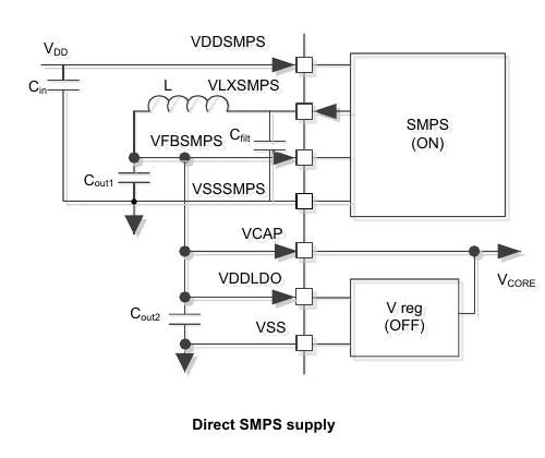

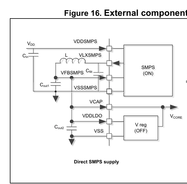

August 2, 2024
Edit:
  • FB1 should definitely not be there.
  • VFBSMPS should not be tied to VDD.
  • Ground planes should be tied directly, but it seems like R1 does that.
  • I don't see why FB12 is present, although I don't think it is hurting anything (provided R1 is placed)
See reference figure in datasheet:
@ABora.4 I updated this reply. My original reply had some issues.
AScha.3
August 2, 2024
@TDK  ,
i think he using direct smps connection, VCAP connected to vfbsmps :
But i wouldnt do this - seems to dangerous to me. If anything wrong with smps hardware or setting - kill cpu.
