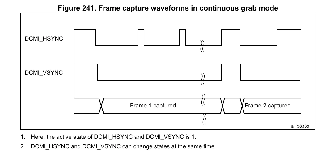

Hi, I have Interface (type MASTER) 10-bit + CLK, FCLK=~9MHz
Can I use DCMI to read 10-bit without VSYNC and HSYNC?
Or some other method? The usual assembler software method "ldr r1, [port, #....]" is too slow and despite many attempts it has not been possible to do it this way.
Cpu CLK ~400MHz, AHB4 ~200MHz, ARB4 ~100MHz

first: what you do with the data ? (You get about 20MB/sec , cpu has ~ 1M RAM , so 1/20 sec to "full" .)
Or how much data to receive?
>DCMI to read 10-bit
Should work, VSYNC and HSYNC together to a pin : hi->lo starts capture (= "frame" for video)

My data has frames that are easy to catch and are not long (around 1kB) and are easy to process from assemble.
Normally I could connect something to DCMI_HSYNC, but I use LCD_VSYNC on pin PA4 (I have VGA output) and I don't have an alternative to DCMI_HSYNC on another pin.
My data is similar to the DCMI interface - 8 bit + clk + hsync + vsync and it would be possible to process it using all pins, if not PA4. Unless there is a way to move LCD_VSYNC or DCMI_HSYNC to a different pin than PA4

So you cannot enable the DCMI at all, because PA4 used for LCD and no more avail for DCMI .
EsKiAuthor
May 12, 2025
I can not configure the pin alternatively for one of the functions, but it will not help.
So how to do fast read (9MHz) 10-bit + external CLK?
Theoretically, it should be trivially simple even in software, because data processing comes down to 2-3 AND, 2-3 SHIFT, write
