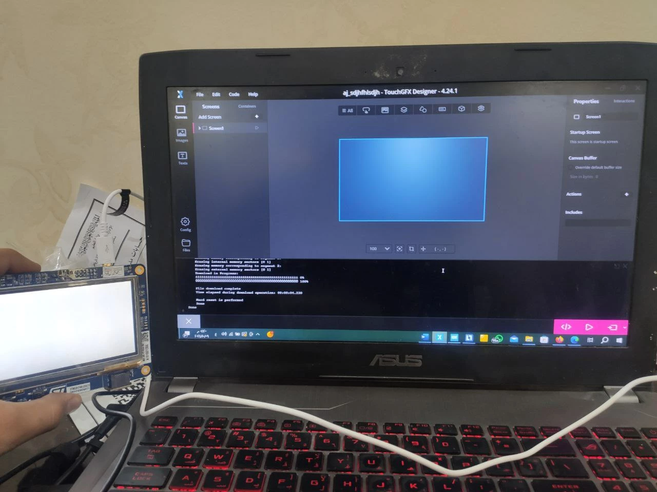

I have an STM32H745 Discovery board. The first problem I encountered was when I was creating interfaces using TouchGFX. I could upload them to the microcontroller via the application without any issues, but when I uploaded the code file through CubeIDE, I encountered a problem. I discovered that I needed to include a boot file.
Once I did that, it worked, and the interfaces appeared, allowing me to modify and upload them. However, when I added the USB host initialization, the screen froze without me adding any line of code. After that, the microcontroller refused to accept any code. I had to use the reset button with CubeProgrammer in power-down mode to restore it before it could take the code again.

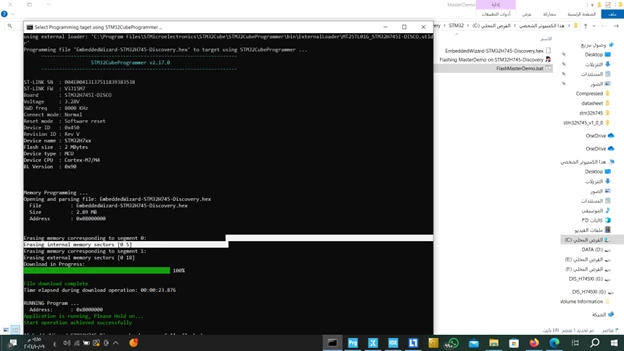

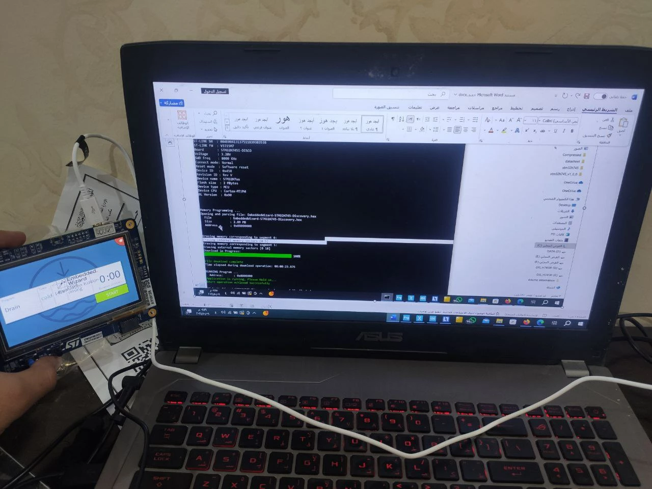

I tried testing the microcontroller by uploading a colored background code. The code uploaded successfully, but nothing appeared on the screen. Note that I have a demo from Embedded Wizard, and when I upload it, the screen works.
Did I damage something with the microcontroller's addressing? How can I fix it

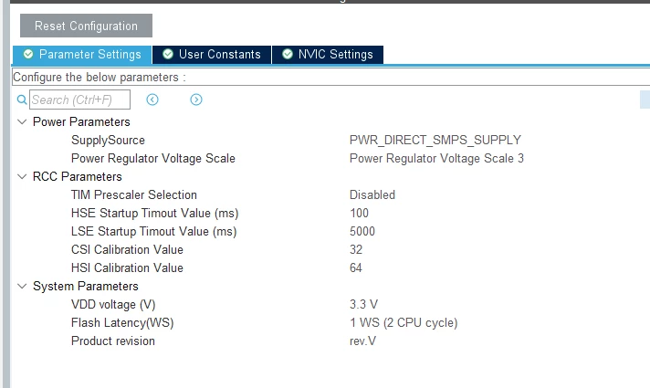

Are you sure your are configuring the Power mode in SMPS and not in LDO config?

"The board works with the demo program."
"The board does not work here, even though it was previously working with the same program."

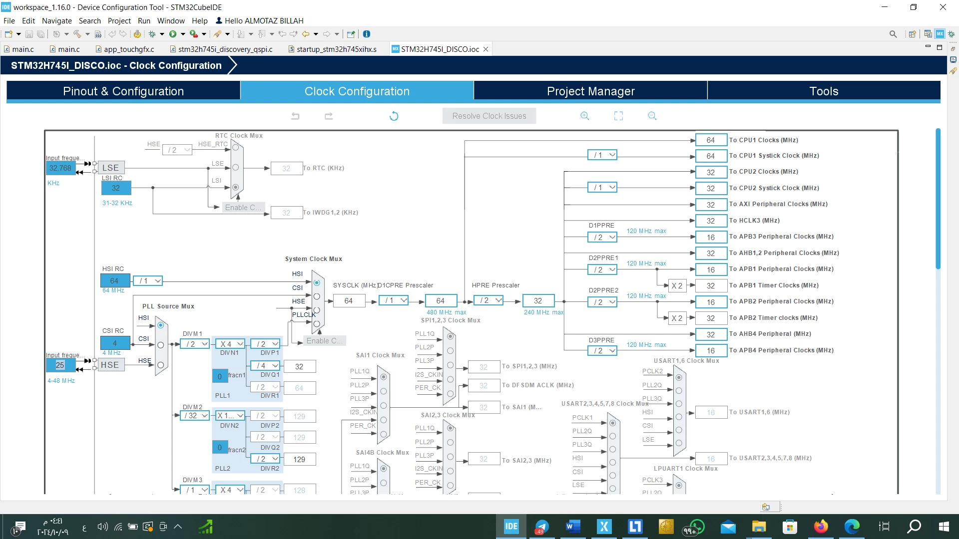

"For your information, I have modified many of the frequency values within the settings. I even raised the input frequency to a value of 48."
mƎALLEm
October 9, 2024
Again what is the power config you set? SMPS or LDO?
The power config needs to be set to SMPS as STM32H745 Discovery is configured in SMPS by hardware.
Show you RCC config from this CubeMx window:
