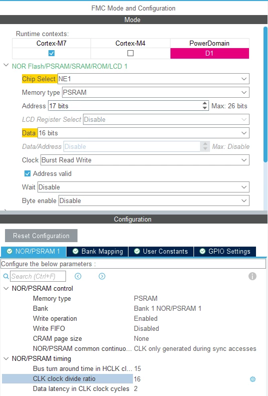

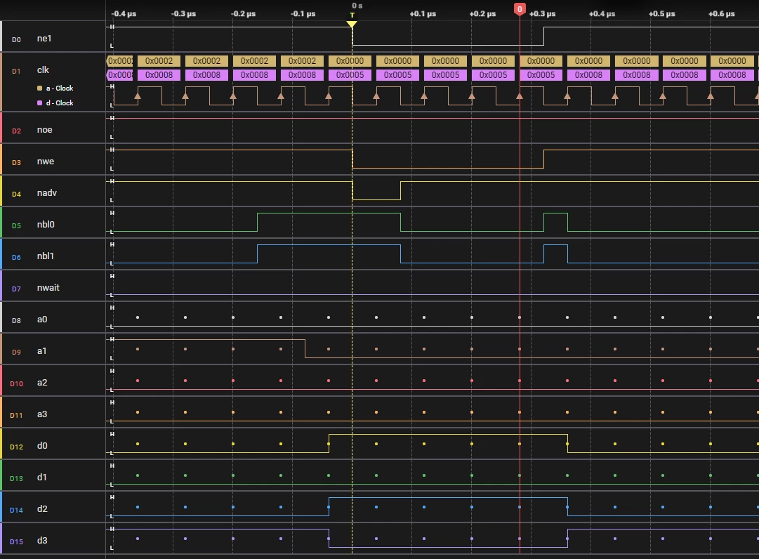

I am trying to get the FMC to work in 16-bit synchronous mode but I only get an output with 4 clocks (64-bit) instead.

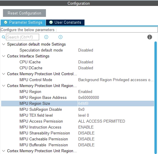

In other threads [1], [2] I found that I should either switch the address from 0x60000000 to 0xC0000000 or enable the MPU, but neither approach works for me.
This is my config:
FMC:
MPU:
Usage:
uint16_t * psram16 = (uint16_t *)0x60000000;
psram16[0] = 0x00AA;
Output:
What am I missing?

According to RM0399, for some PSRAM memories which must be configured to Synchronous mode, during the
BCR register writing, the memory attribute space must be configured to device or strongly-ordered. Once PSRAM BCR register is configured, the memory attribute of PSRAM address space can be programmed to cacheable.
Could you please check these settings?
Thank you.

Kurngop32Author
December 8, 2023
Not sure what this means. Isn't that the MPU setting?

Hi @Kurngop32 ,
Yes, I mean that the memory region MPU attribute must be configured as “Device" or “strongly-ordered".

This leaves more questions than it answers. In the example, additionally to what I already did, another memory region at 0xA0000000 is created, no idea why since this is reserved space, but it does not help anyway. To be sure I set the whole memory to strongly-ordered, but that does not change anything. The output looks still the same, i.e. 4 clocks instead of 1.

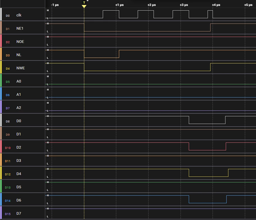

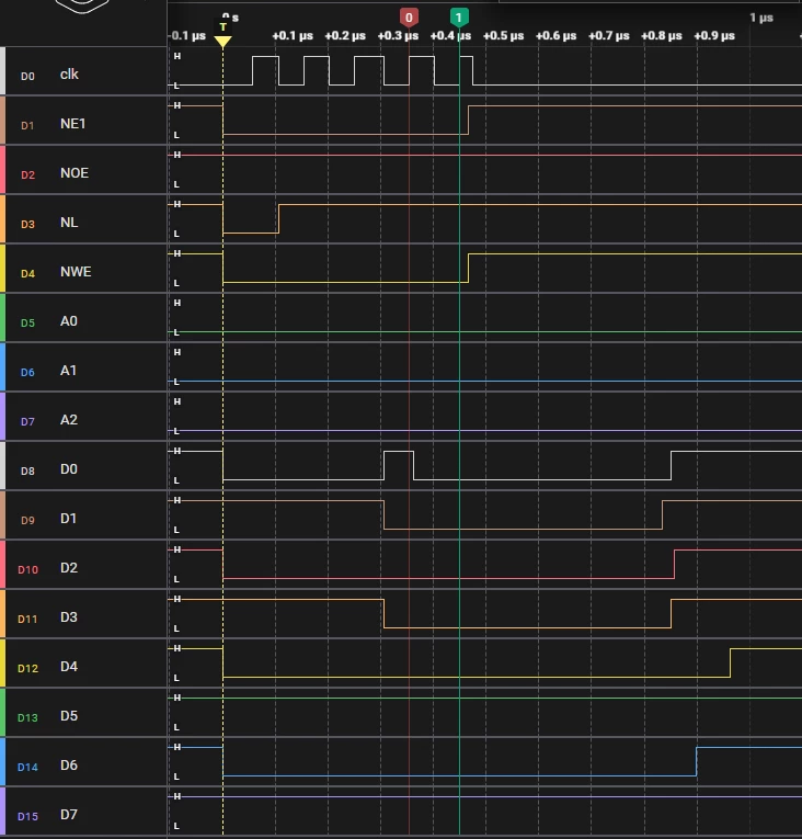

Kurngop32Author
December 8, 2023
btw this is how a 32 bit access looks:
uint32_t * psram32 = (uint32_t *)0x60000000;
psram32[0] = 0x00A000A1;
5 clocks, so also 3 unnecessary clocks (or my expectation is wrong, I don’t have much experience with external memories)

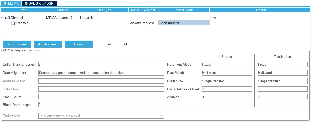

Kurngop32Author
December 20, 2023
No difference with MDMA.
uint16_t src=0x1234;
HAL_MDMA_Start(&hmdma_mdma_channel0_sw_0, (uint32_t)&src, 0x60000000, 2, 1);
You can make a new project (STM32H745XIH6, FW H7 1.11.1), with the settings from the first post. I didn't change or configure anything else.
FMC is accessed right before the main while loop.
