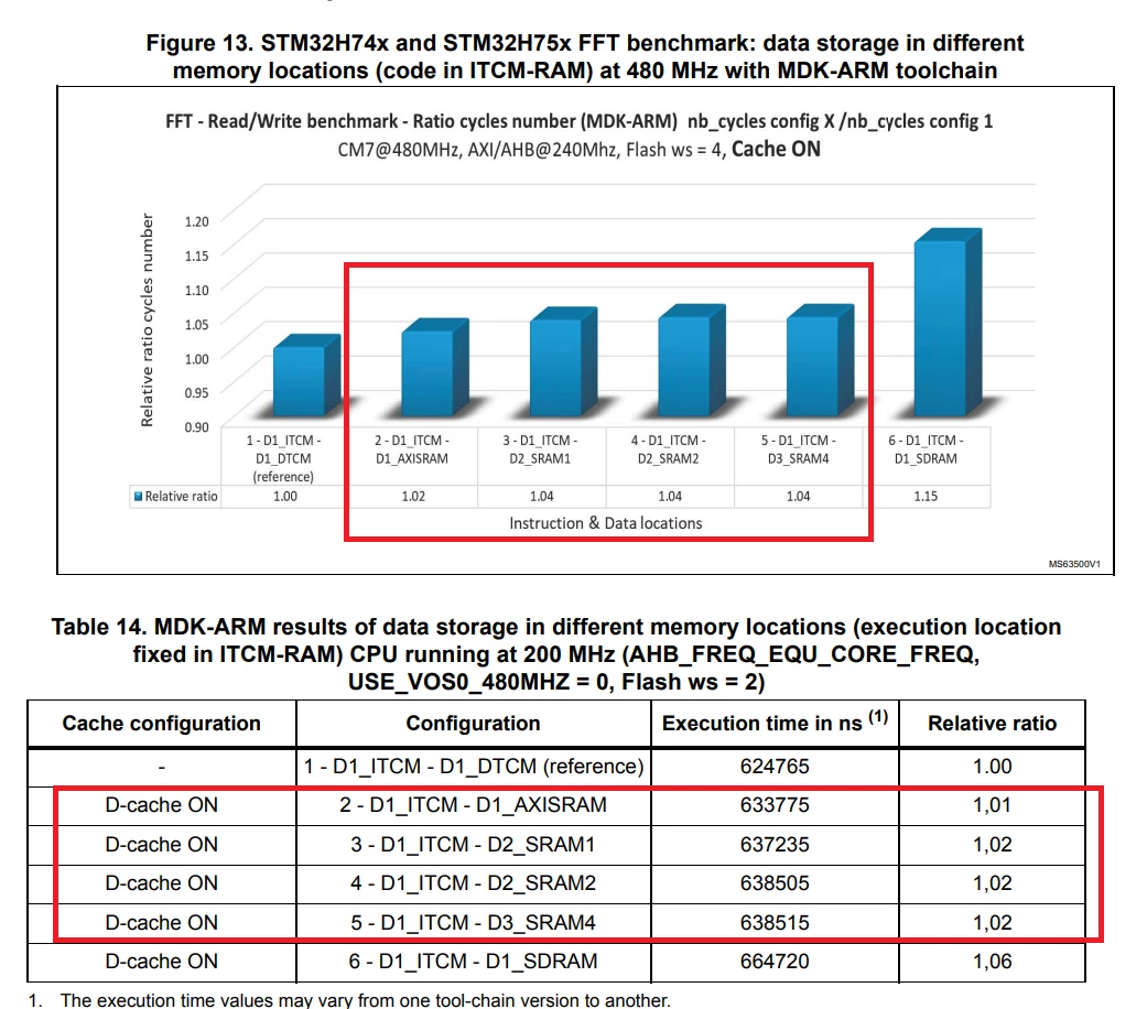

If you look at the AN4891 "STM32H72x, STM32H73x, and single-core STM32H74x/75x
system architecture and performance", using AXI-SRAM is a bit better in term of performance for CM7 than the other SRAMs located in D2/D3 domains. Don't forget there are bridges to connect D1 to D2/D3 domains.
