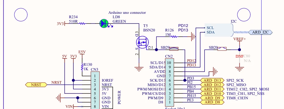

My board schematic :

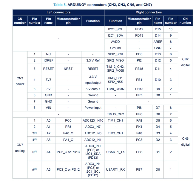

My board pin definition :

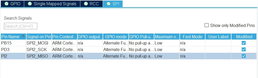

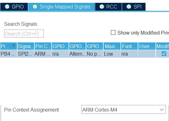

And my board .ioc initialization :
for CS:
for the rest on my pins :
