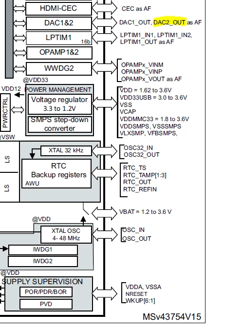

I would need dual DAC using STM32H745. According to datasheet, it should have two DAC converters. In STM32CubeIDE, I can see only DAC1 with two channels. In the datasheet, I can only see DAC1_OUT1 and DAC1_OUT2 pins, but no DAC2 out pins. Is there DAC2 available in STM32H745?

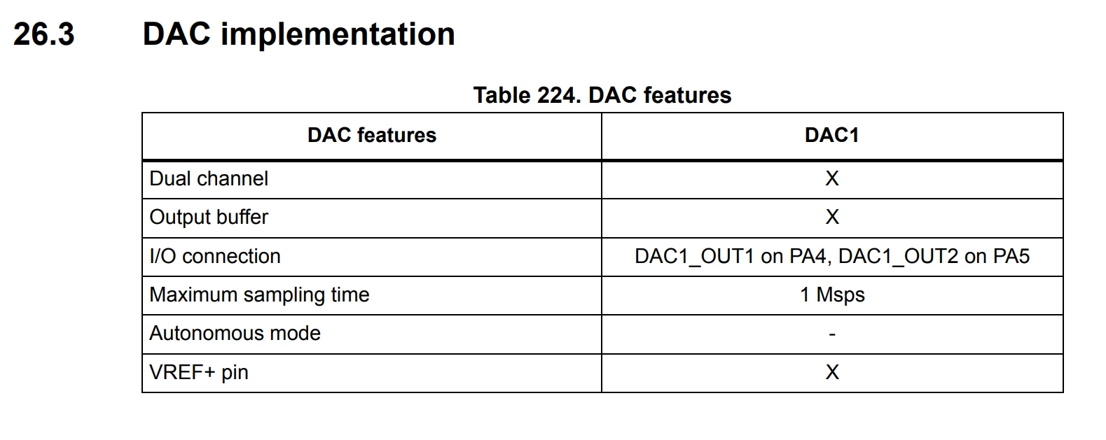

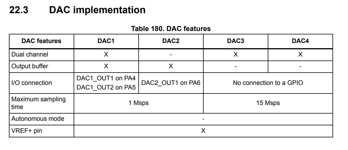

Please refer to the reference manual DAC implementation section of the correspondent product:
For example STM32G4 has 4 DACs:
This is for STM32H743. It has One DAC with 2 channels.

There is only one DAC with two channels on this product in the datasheet:

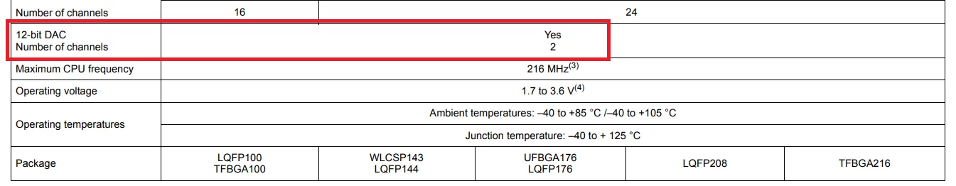

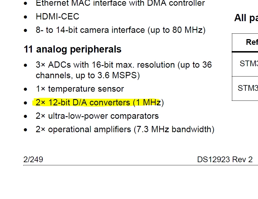

I'm a bit confused as everywhere has stated two DAC:
So, there is error in datasheet? Even product selector claims that there are two DACs. Is there any model of STM32H7 family, which actually has dual DAC?

There is a dac module with 2 channels, out1 and out2 ; these are the outputs of the two DAC.
Just the name is not what you expected.

STM32H745 and STM32H743 have the same DAC implementation. So you have one DAC instance with two channels (DAC1_OUT1/DAC1_OUT2).
But indeed there is an issue in the second screenshot DAC2_OUT needs to be DAC1_OUT2 and DAC1_OUT has '1' is missing.
