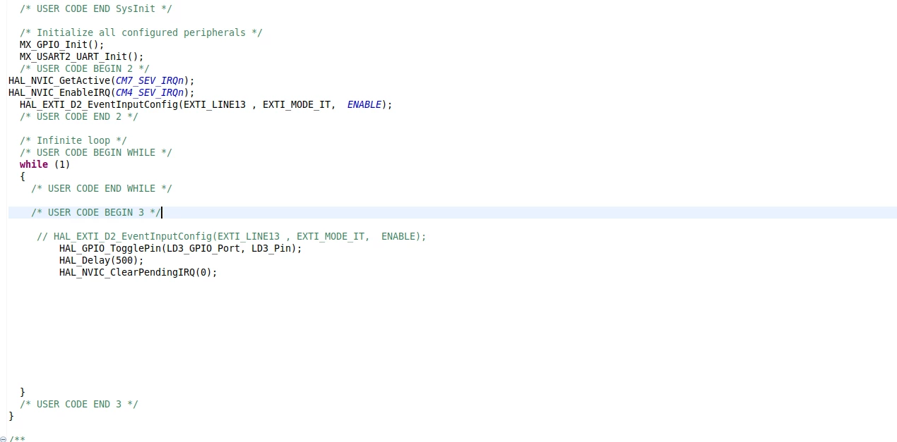

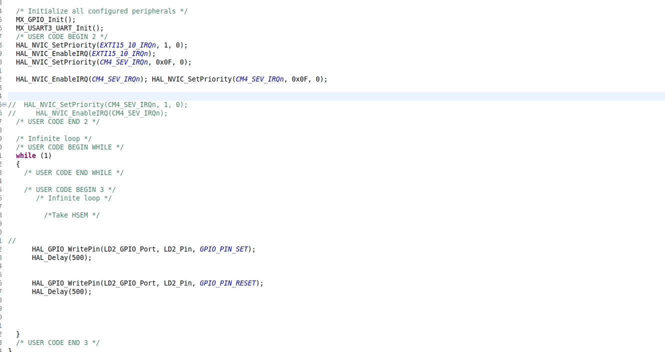

I'm trying to create multicore communication in Nucleo-H745zi. I want to call interrupt in the second core. I just want toggle LED in second core after interrupt came from first core. I checked the articles and other stuffs on internet but i can't able to understand how i actually write that code .
In NVIC2 there is an option CM7 send interrupt to CM4 i enabled it but i didn't understand how to execute it . If anyone know about it please help me with same.

Hello @pshin.2​,
After defining an interrupt handler for the first core (CM7). This function will be called when the interrupt is triggered. HAL_NVIC_SetPriority() is meant to be configured in order to preempt CPU1 and CPU2
 /* Enable and set EXTI lines 15 to 10 Interrupt to the lowest priority */
 HAL_NVIC_SetPriority(EXTI15_10_IRQn, 2, 0);
 HAL_NVIC_EnableIRQ(EXTI15_10_IRQn);
 /* Configure the second CPU (CM4) EXTI line for IT*/
 HAL_EXTI_D2_EventInputConfig(EXTI_LINE13 , EXTI_MODE_IT, ENABLE);
Then, using HAL_EXTI_D2_EventInputConfig () function configures the EXTI input event EXTI_LINE13 for Domain D2 for the second core (CM4) to receive the interrupt event from the first core (CM7).

Hey i don't want to use any memory , I just want to send any type of interrupt from CM7 to CM4 without using any type of memory . I used CM7 send interrupt to CM4 this and add
this in main.c of cm7 and add
this in main.c of cm4 i attached the code image with it please go through it .
I just dont able to undarstand how its actually works. please help with same.
