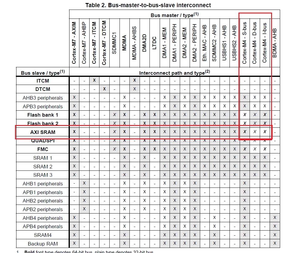

mƎALLEm
mƎALLEmBest answer
Feb 17, 2025 2:33 PM UTC
First, please use </> button to share a code or linker script. See this link.
Second, I'm not expert of linker files. But as I said previously you need to select the AXI-SRAM (512K).
To me this is OK:
MEMORY
BOOTLOADER_FLASH (rx) : ORIGIN = 0x08100000, LENGTH = 256K
BOOTLOADER_RAM (xrw) : ORIGIN = 0x24000000, LENGTH = 512K /* previously = 288K */
You need to test it.
@baycanakcay wrote:
or do I need to explicitly define all ram sections in application linker?
You don't need to define unused RAM in the linker files.
4 replies

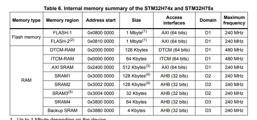

mƎALLEm
Feb 17, 2025 1:08 PM UTC
That's normal. SRAM1 to SRAM3 are contiguous and can form a SRAM block of 128KB+128KB+32KB = 288KB. This is the maximum you can get with that block.
AN4891:
You can use AXI-SRAM in D1 domain with 512KB (0x2400 0000). It's accessible by the Cortex-M4.
RM0399:
Hope that answers your question.
