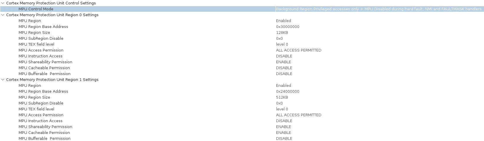

Now I want to check whether enabling the D-Cache can actually further improve execution speed. My intention is, to use this Cache solely for a faster reading/processing of the DMA-Buffers in AXI_SRAM. Their reading happens upon a DMA half- or full-complete interrupt and the D-Cache is always invalidated before accessing any DMA-Buffer data. SRAM1 stays non-cacheable.
This is my new setup:
Instruction Memory:
  • ITCM for time-critical functions
  • FLASH (+ I-Cache) for remaining instructions
Data Memory:
  • AXI_SRAM (+ D-Cache) for two DMA-buffers (Peripheral to Memory)
  • SRAM1 for another DMA buffer (Memory to Peripheral)
  • DTCM for everything else (including ISR table)
MPU:
  • Region 0 = SRAM1 (non-cacheable)
  • Region 1 = AXI_SRAM
_legacyfs_online_stmicro_images_0693W00000bjNzKQAU.pngHere I am facing a weird problem.
When I download the program to the nucleo, it often does not start and instead goes to the error handler. However, when I press the reset button a couple of times, it suddenly starts and runs perfectly fine.
Has anybody faced a similar problem? Can somebody help me debugging?

mƎALLEm
May 4, 2023
First try to disable the access to non valid memory regions using MPU:

DWeng.1
DWeng.1Author
May 4, 2023
Thank you for your answer. Unfortunately, the problem remains.

DWeng.1
DWeng.1AuthorBest answer
May 5, 2023
I think I found the problem now! The reason for the Error Handler lies in this section of Code that is called by MX_USB_OTG_FS_PCD_Init().
 * @brief Reset the USB Core (needed after USB clock settings change)
 * @param USBx Selected device
 * @retval HAL status
static HAL_StatusTypeDef USB_CoreReset(USB_OTG_GlobalTypeDef *USBx)
 uint32_t count = 0U;
 /* Wait for AHB master IDLE state. */
 do
 if (++count > 200000U)
 return HAL_TIMEOUT;	/* This timeout causes Error_Handler() when building in release mode */
 } while ((USBx->GRSTCTL & USB_OTG_GRSTCTL_AHBIDL) == 0U);
 /* Core Soft Reset */
 count = 0U;
 USBx->GRSTCTL |= USB_OTG_GRSTCTL_CSRST;
 do
 return HAL_TIMEOUT;
 } while ((USBx->GRSTCTL & USB_OTG_GRSTCTL_CSRST) == USB_OTG_GRSTCTL_CSRST);
 return HAL_OK;
Apparently the counter value increases much faster when building in release mode (-ofast) and when D/I-Caches + D/I-TCMs are used in addition.
Increasing the counter threshold from 200'000 to 400'000'000 fixed the problem.
Now everything works perfectly fine :)
Is there somewhere a bug report portal where I can report this?
mƎALLEm
May 5, 2023
Is it possible to declare the counter as volatile __IO uint32_t count and tell us if it does fix the issue?
DWeng.1
DWeng.1Author
May 5, 2023
Yes changing the variable from uint32_t to volatile __IO uint32_t and leaving the counter threshold at 200'000 works too.
