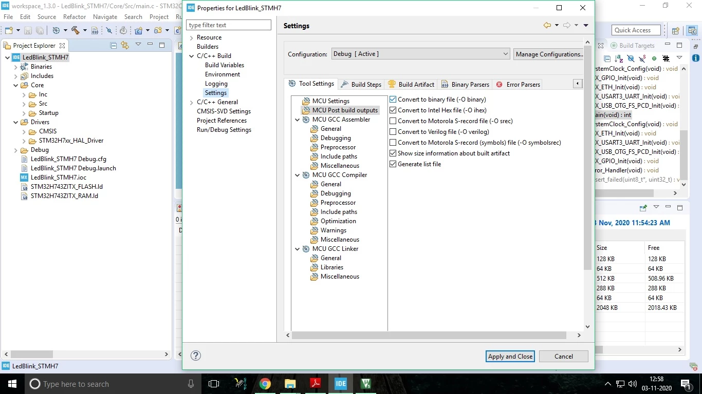

(STM32H743Zit6 Dev. Board) Generate Bin file from zero address?? Need to generate bin file at start address 0x08000000
I am using STM32H743Zit6 Dev. Board. while hex file file generation , program code is in 0x08000000 and upload it works fine.
when i want to generate bin file, so i use the following steps. Bin file generate is successful but program code is from zero address location.. Can anybody give suggestion to solve the problem...

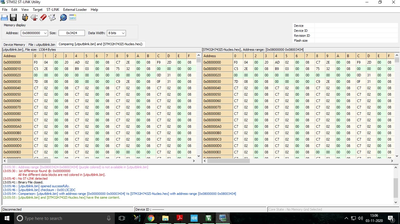

BIN files do not have an address associated with their data, unlike ELF/HEX files. They only have the data.
To upload a BIN file, you specify the offset during programming. The ST-Link Utility is smart enough to set the flash address as the default.

Dear TDK,
Thanks to you. Now it works fine.
