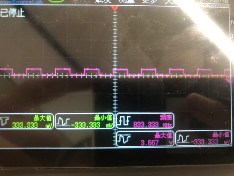

STM32H743zit6 After the timing interrupt is enabled, the interrupt callback function is executed repeatedly, and other programs cannot be executed?

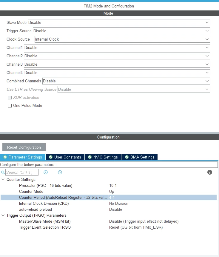

  • CUBEMX Settings as above:
  • The callback function is as follows:
void HAL_TIM_PeriodElapsedCallback(TIM_HandleTypeDef *htim)
	if(htim->Instance == TIM2)
		LL_GPIO_TogglePin(CLK_GPIO_Port,CLK_Pin);
  • The call code is as follows:
USB_printf("1");
HAL_TIM_Base_Start_IT(&htim2);
USB_printf("2");
  • The result is shown below:
_legacyfs_online_stmicro_images_0693W00000bVhbyQAC.pngAfter receiving 1, the serial assistant no longer receives it and has no reaction when stuck, the pin turns over normally, and the callback function executes normally.

833 KHz? Really? :face_with_medical_mask:

I want to output a 4MHz frequency clock signal.Can't it do that?
Piranha
Principal III
June 7, 2023
For such purposes timers have output channels, which can generate PWM. Read the reference manual and application notes.
